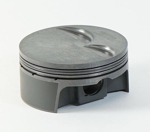

If that's correct, that's probably the winner right there. Have a pic of these, maybe?
Look at Mahle
930221525
They’re lightweight and low cost. They also have fairly small valve pockets. The small valve pocket may be part of why the rings can be up higher to give more room for the pin. I got one of my kits off eBay with a Black Friday eBay discount code in total I paid $570 in 2018 for the set. Bought some total seal gas ported rings for them. From all appearances, the 1/1/2mm ring pack that comes with them is the same as what Total Seal used before cutting the grooves.

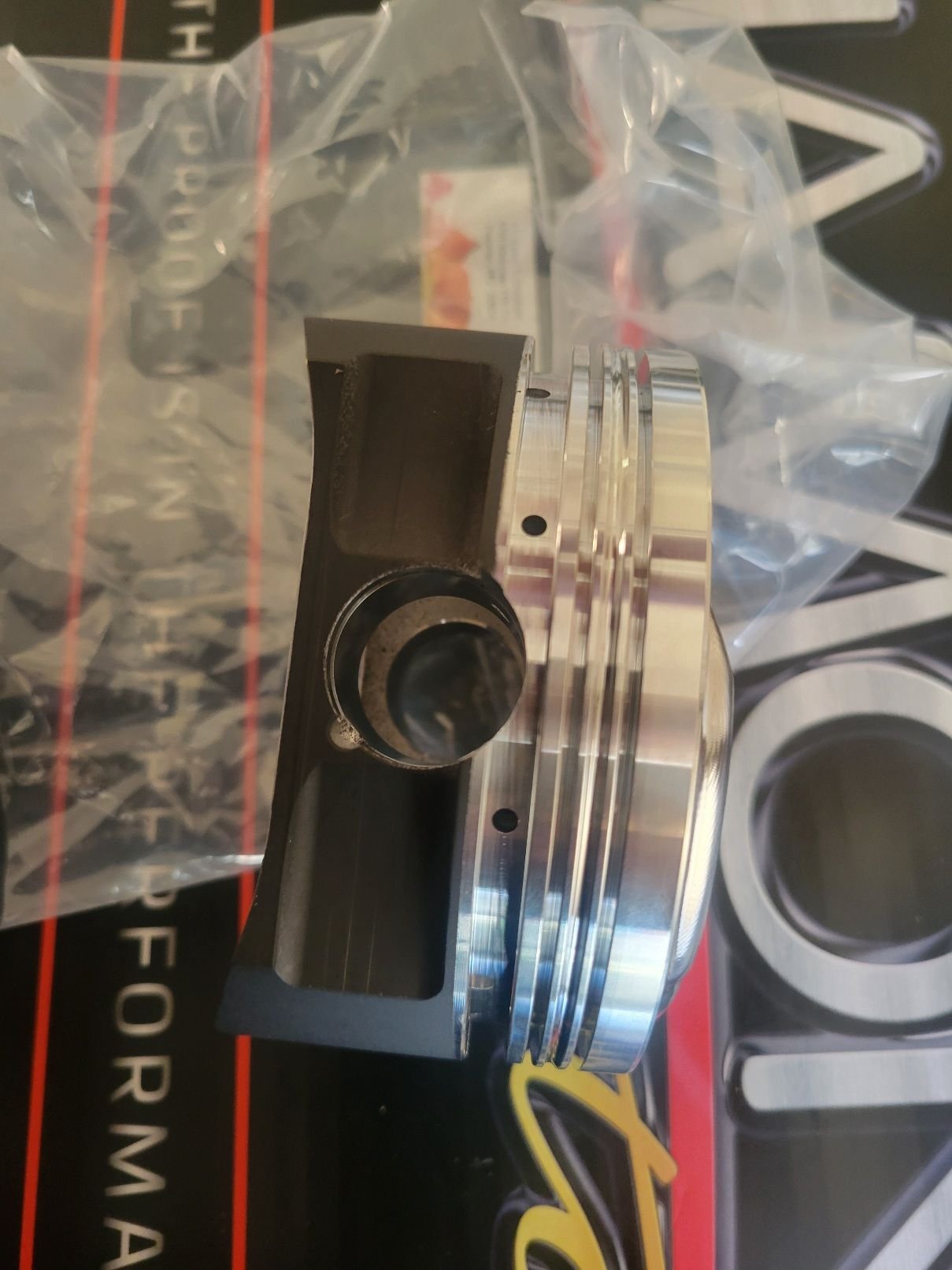

Here is my 540 BBC Diamond piston with the 4.25 stroke and the 6.385 inch rod. has a little of the oil control ring open to the bottom. Here is the LS piston with 4.125-inch stroke has a little more open to the bottom - Wiseco. The Wiseco LS piston the second ring was moved down .050 to help with piston support also has special taper in thrust area.

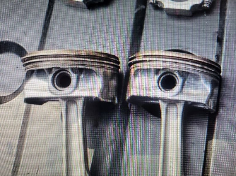

Here is OEM LS7 piston (4-inch stroke) - GM really squeezed all the rings in there. Shorter rod and small piston pin.
