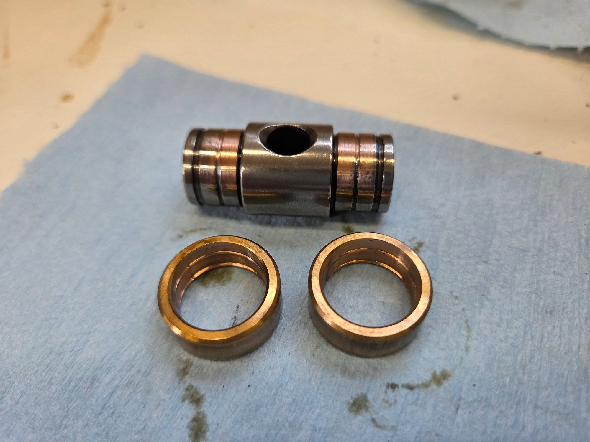

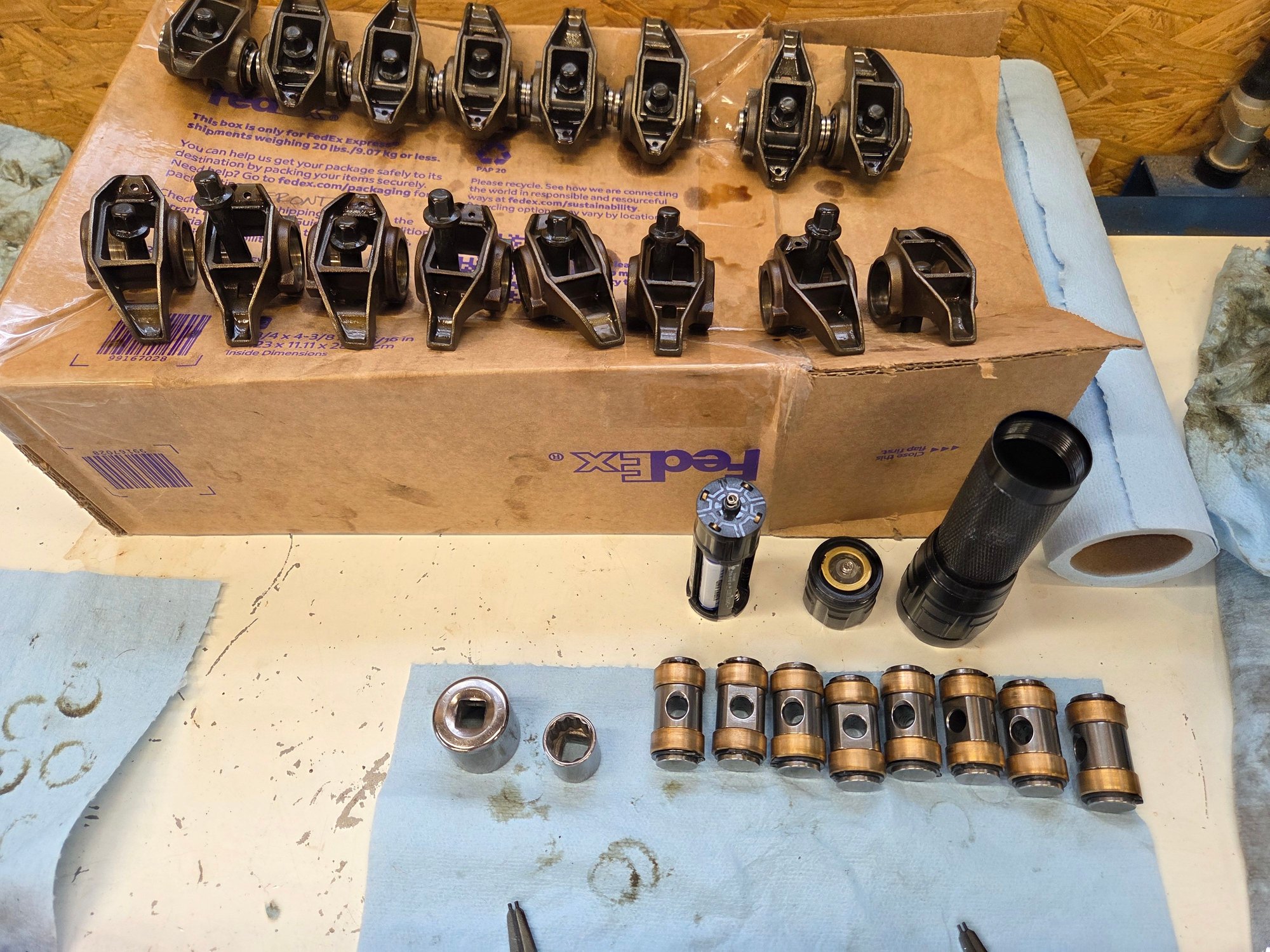

Don't buy the Summit kit, SUM-141560. These have less than 15k miles on them, with a .600/.575 lift cam. All are the same, with very noticeable grooving.

It is hard to tell from the pics, but the grooves I think I'm seeing look to be oil grooves that are machined into the bushings and trunnions, to help hold extra oil. Not seeing any wear grooves. Have you inspected the diameters, inner and outer, for any egg shaping or out of roundness?
The grooves you see in the bronze are not there from the factory. The bushings are smooth out of the box on both sides, and the grooves have been worn in them over time.
