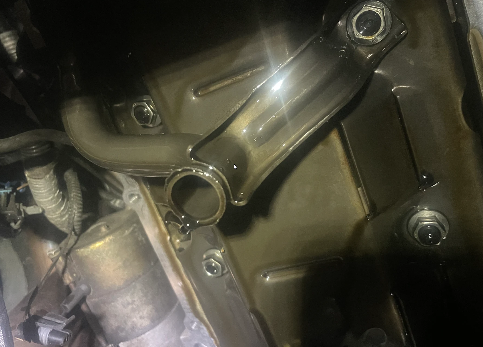

Mine looks very similiar with a GZ vacuum pump pulling 13" hg. Running a Mamo 10355 pump, 10an lines to a 25 row cooler.
I would like to mention, mine was dropping to 20 psi prior to this at WOT. But the problem was a bit more aggressive:
