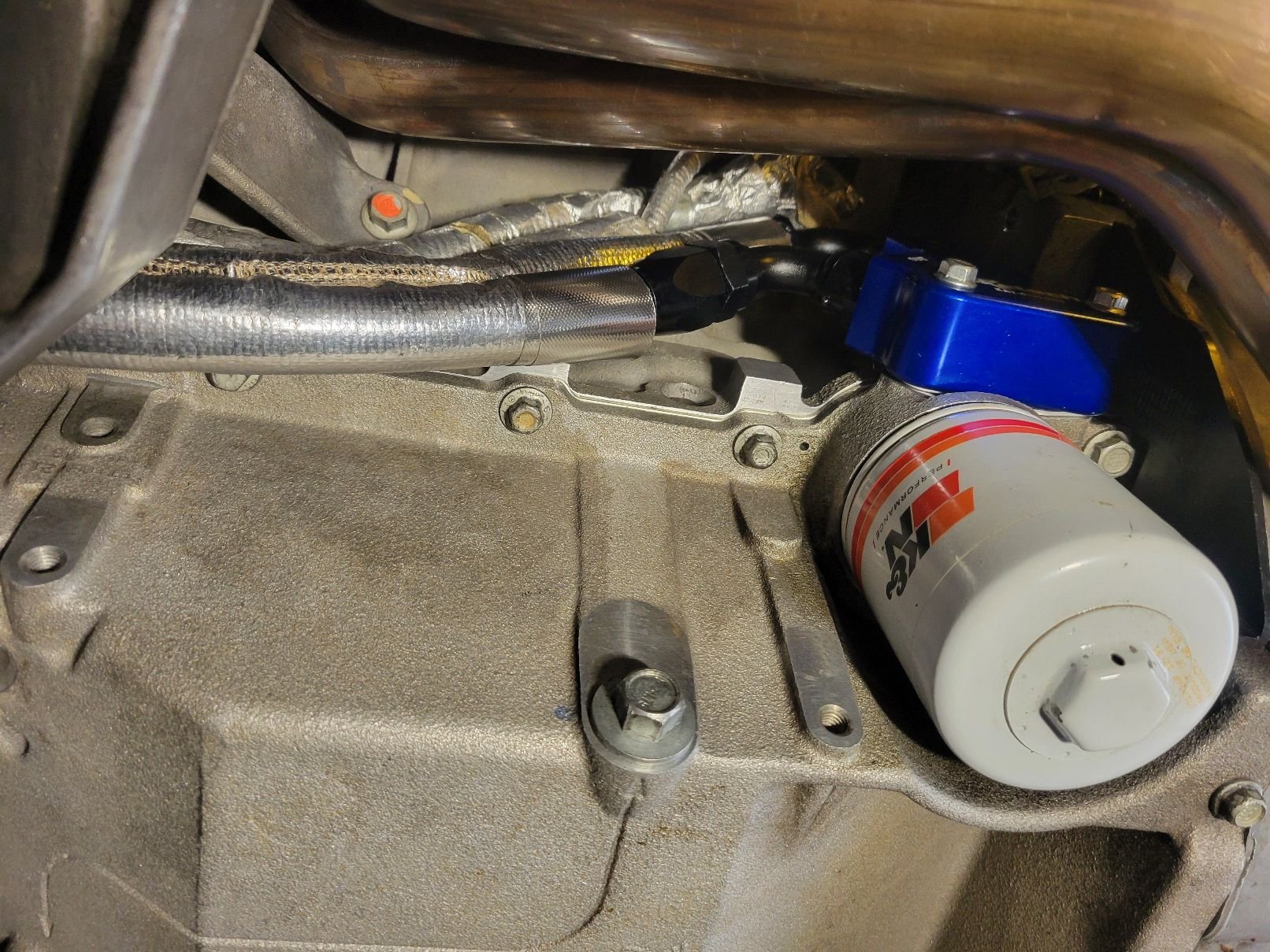

How are you feeding the oil cooler from the block and what oil cooler. Is something clogged there? This is mine on my C6 Z06. Number 10AN like you.

Pretty much the same way. A G-Plus brand block, no thermostat. All those pieces were new when installed. A clog in the cooler did cross my mind.
