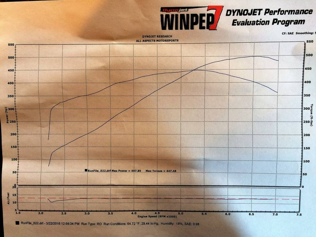

Not ideal, but should run ok. Specs are not so far from a Spinmonster 230/234 cam which regularly makes 500whp. The biggest downside to the Sloppy cams are the lobes are not great design, so specs are ok, but reality is lack luster. The Summit 8710r1 230/242 makes lots of power in an LS3 w/ headers. Considering the amount of work and expense, I would do the cam you want, not the cam you have.
I forgot the tuner in middle America but they used a 230/242 in a 416 stroker and it made 500/500.
I used it in a 6.2 and it made 496rwhp in a C6. I then went with the 230/234 and it lost 3hp but gained Tq down low with less overlap and drover better. Both cams used a 114lsa.
That was the exact comparison that made me shy away from big splits. The 4-degree split made within the dyno error of a dynojet in comparison.

238/242 would need a completely different head to be optimum. I'd imagine the Trick Flow's are a great match. High compression would make up for the lost Tq as would big displacement. The 230/234 is a great match for a 6.2.

Hey there, nice to see you post 👍. Your cam is legendary, I do like specs a lot. I def consider it better than than 8710r1, but the conversation turned somewhat. I actually like the specs on the Sloppy Stg3 at 238/242, similar 4 degree split like yours, but upping the powerband obviously, but their lobes are not all that great. If yours out torques the 8710r1, then that's the winner. I will say this, I like the Summit 230/242 better than the BTR version. I think the BTR lobes are not all that and the . 660 springs are crap once they get time on them. I think the Summit(Comp) lobes are way better overall.
Good to see you still carrying the torch.
Trick flow 235's raises power to 521/469.
I'm not up on all cams out there but the Tq on mine:
