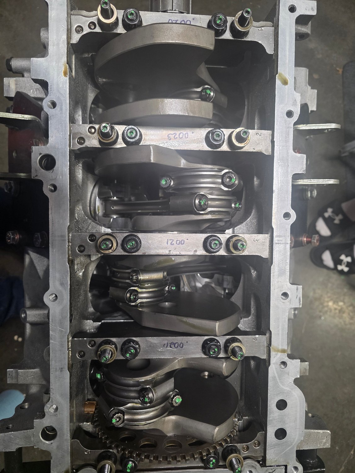

After pulling the 416 apart and finding what appeared to have glazed over cylinder walls, i decided to just re-ring the engine and new bearings.
All the bearings looked good. Maybe a few tiny grooves from small bits of trash going thru them. No marks on the rod or crank journals.

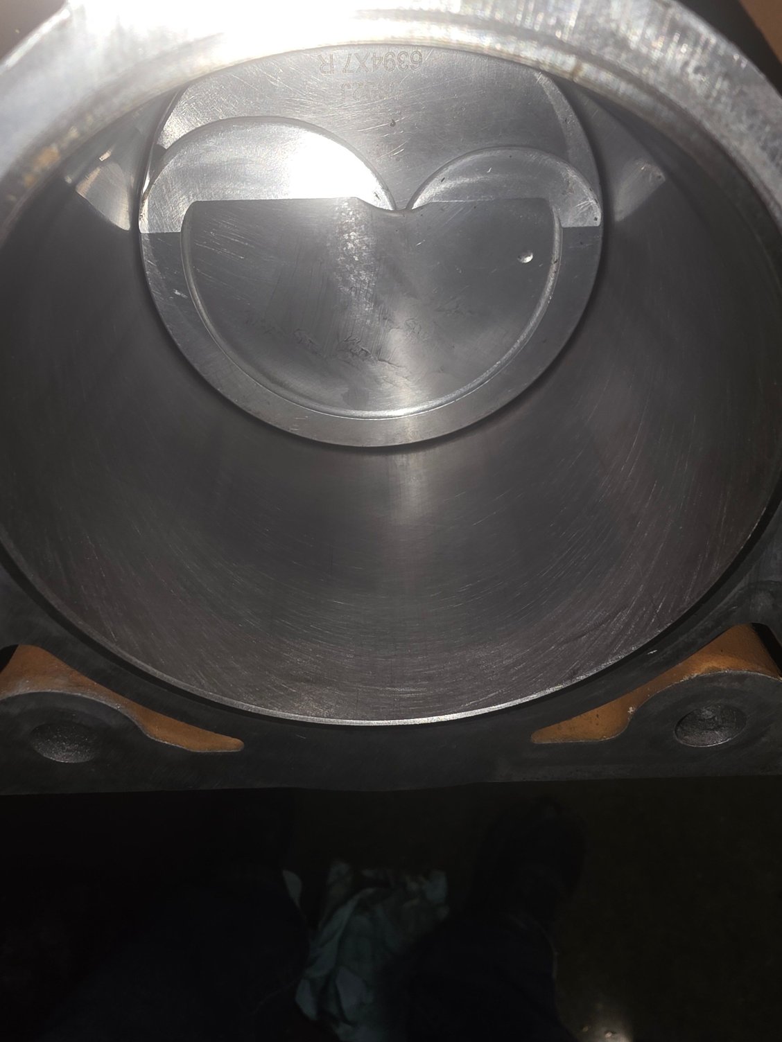

I honed the block with a 400 grit Dingle ball hone, with about 4 to 6 strokes. Some cylinders required a few more strokes to get the glaze off the walls and look better than others.
Last times my ring gaps i set up at .022 top and .026 bottom. This time i set them up tighter with .018 and .020.

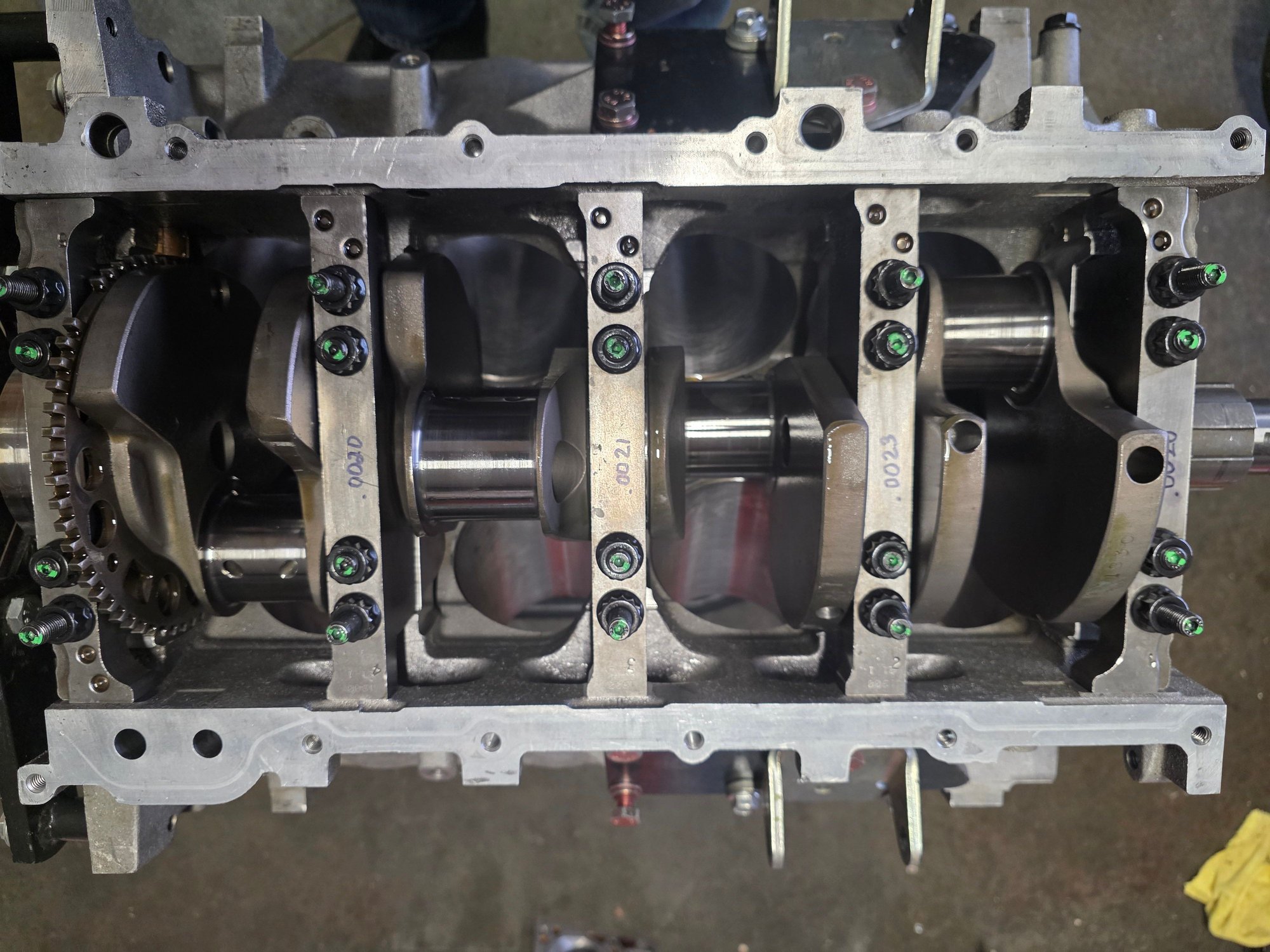

Main bearing clearances are set at .0020 to .0023
Thrust is at .007
Setting up the rod clearances today.

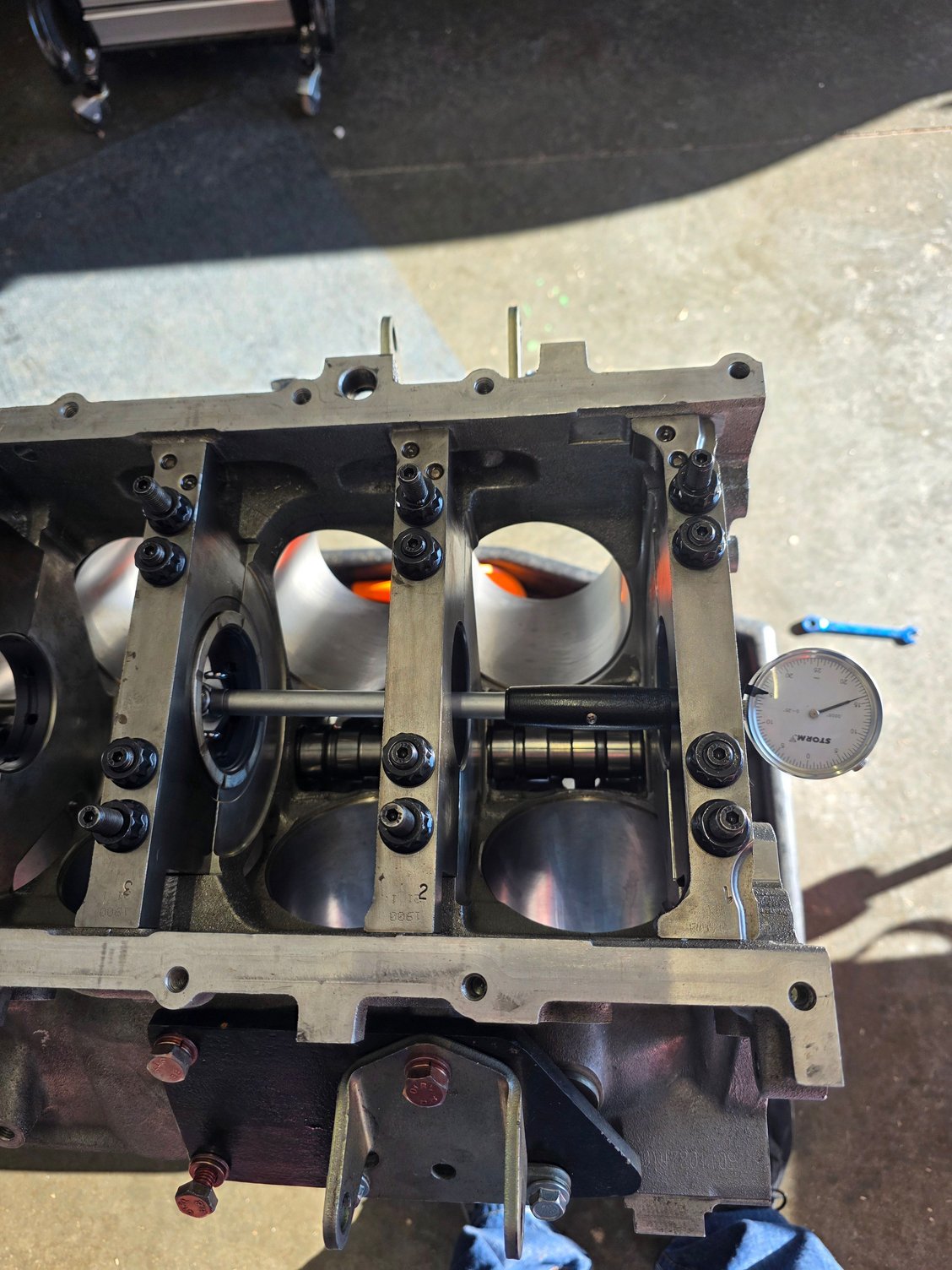

Rod clearances came out .0025 to .0028
that was with using a king xp std size half and a x bearing. Something weird, last time the x bearing was giving me .0005 extra clearance. This time they all where closer to .0010 extra clearance.
Bores honed up nicely.  Alot better than the glazed look like before.
