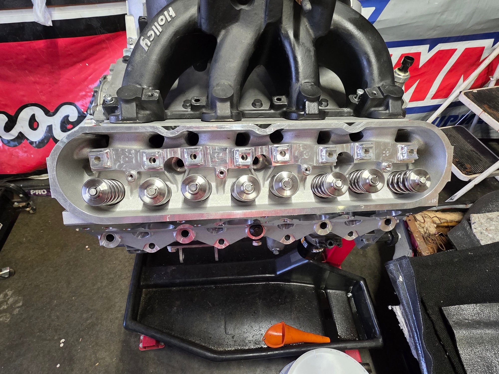

Finally got the heads delivered. Just mocking them up with 1 head bolt installed and intake manifold just sitting on top, the new heads port alignment is way better than the old tfs 235s.
The port width at the entrance on the old 235s where 1.069 wide vs the btr heads have a 1.1150.
New btr head along with holley split single plane
Holley single plane with tfs 235 heads

She's a beaut. Can't wait to see how it does! Any plans to put it on the dyno?

This should be very interesting. Heads look great did the flow them at all?

im not sure as I didn't get a flow sheet.

no plans for engine dyno, maybe a chassis dyno.
