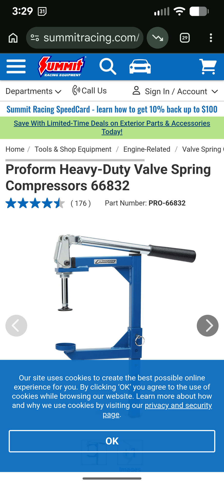

What about the ProFrom 66832 ?
I just purchased the LSM SC-2000 unit and it was worth every Penny!!! I Broke a few different units prior. I Broke 2 of the ProForm 67605 and a BluPoint Air powered unit.

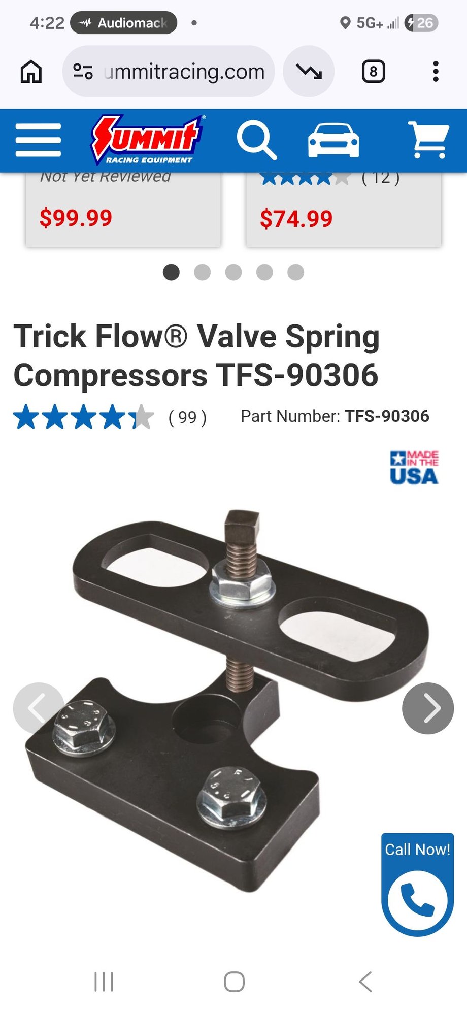

I just changed mine this past weekend and I used the trick flow one, I installed pac 660 titanium dual springs and also removed similar springs, the old ones weren't titanium.

This is the one i use
