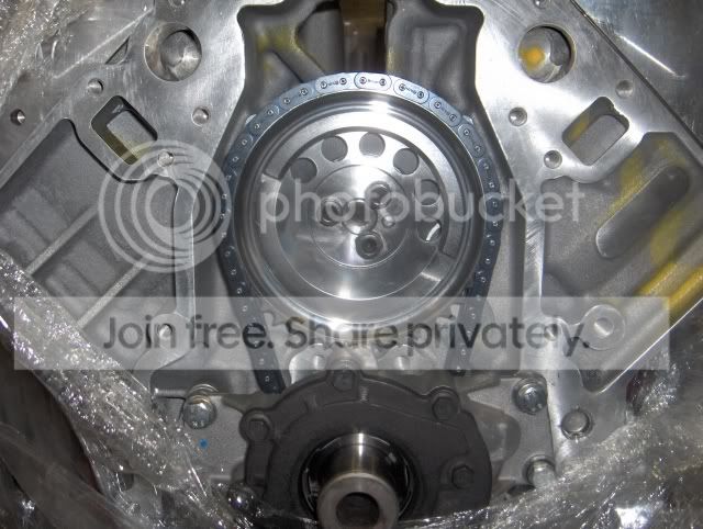

Heres our new 430 LS7 with ported LS7 heads pics I have it for sale
Old Mar 30, 2007 | 06:12 PM
Hassan's Avatar
Joined: Aug 2006
Posts: 2
More information please ie rods, crank, pistons etc..and price?
