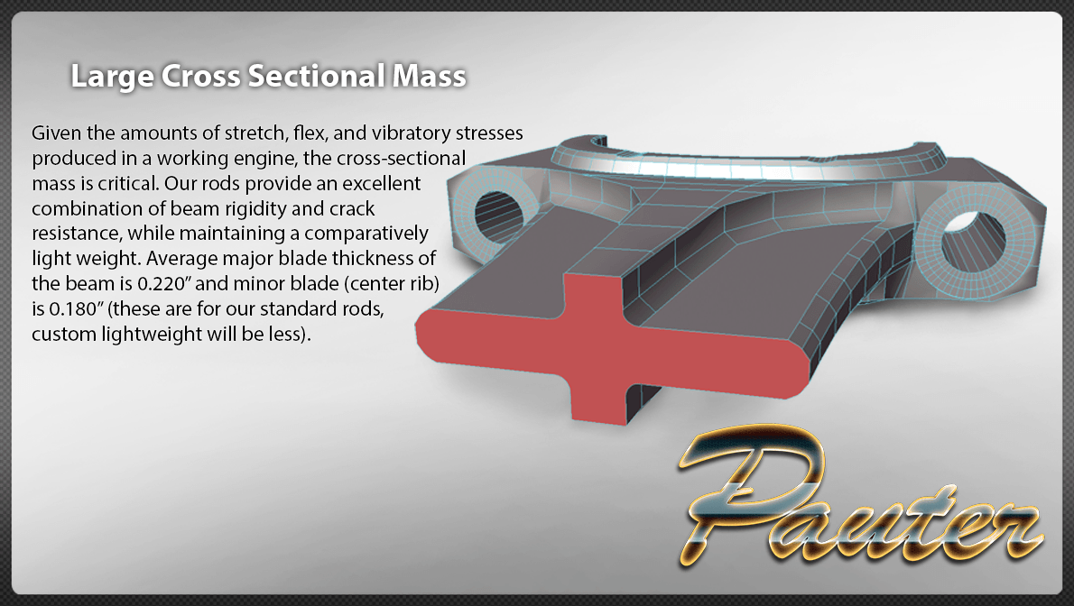

Pauter x-beam. Although it isn't the lightest by far, it is very very strong. Although they also make it in Ti (custom order) to bring the weight down.

Ive never even heard of an x beam before.
Hense the picture above.
