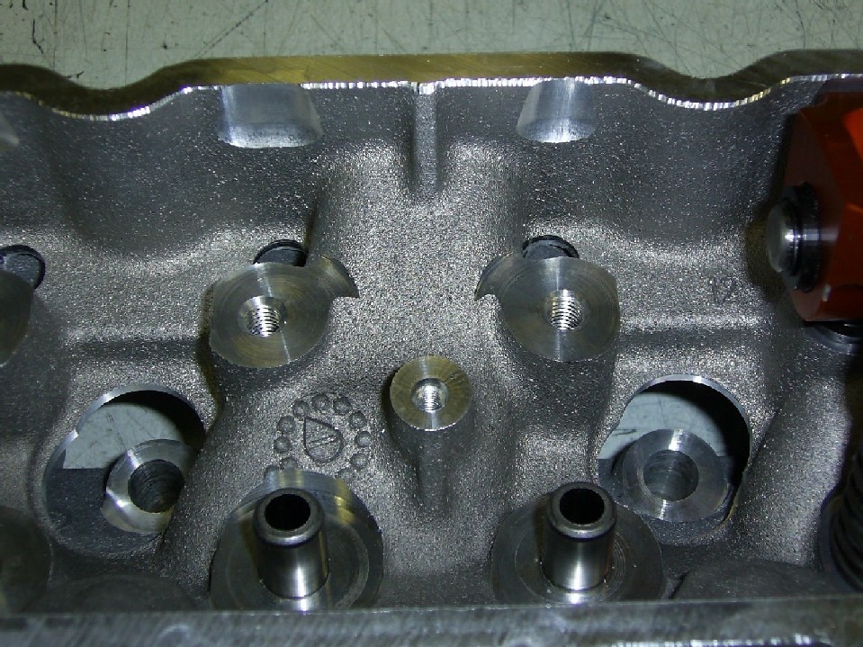

You need to clearance the backside of the intake flange. We made a program to do this on the CNC. It can be done by hand, but you'll have a mess of metal shavings when you grind on the heads. This is best done before the heads are assembled and installed.
This is what needs to be clearanced:
Hope this helps.
Richard

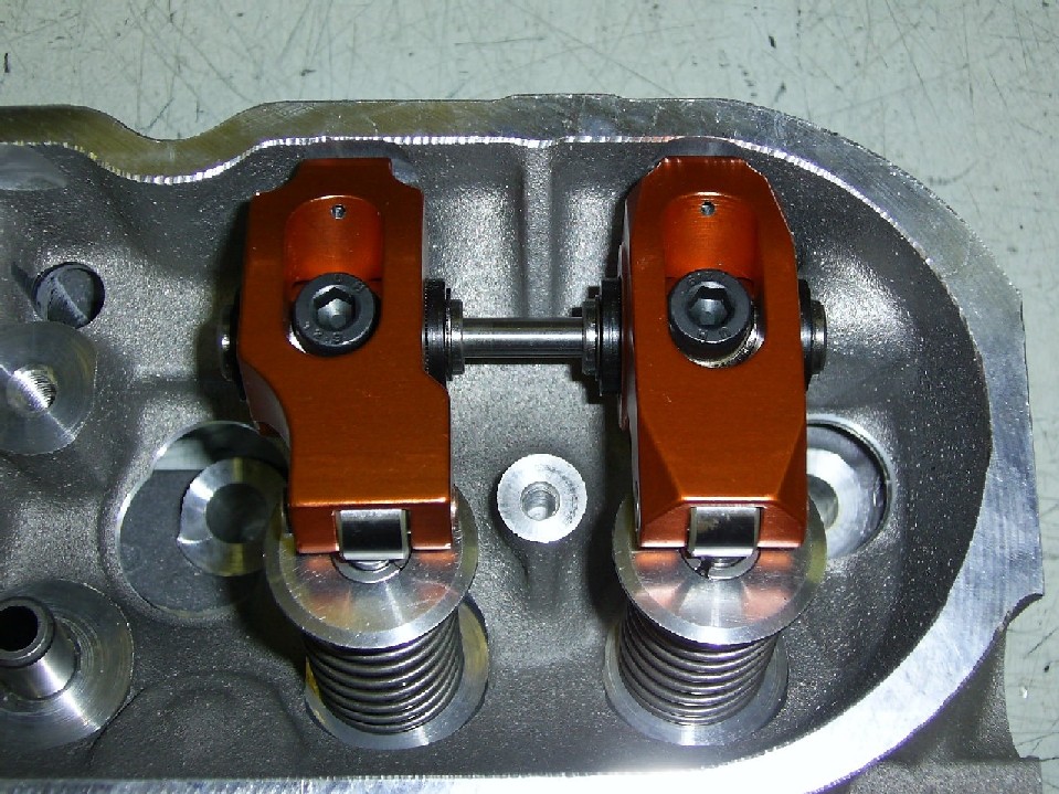

What I see in the picture is grinding that has been done to the head. I dont have any clearance issues there my problem is the rockers hitting the valve covers. The rockers in the picture seem to be offset,is that an L92 head?
