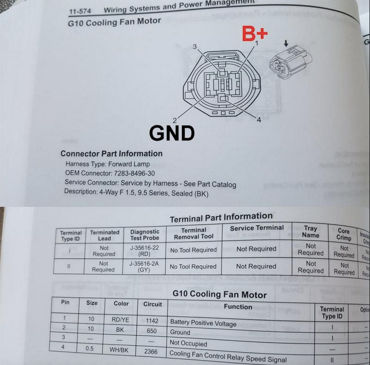

Okay I’m finally at the point where I have to wire this up. Seems pretty easy except how do I know which terminal is 12v positive and which is negative haha. They’re both black.
for some reason I assume the top is positive.
Thanks
Sean
Old Feb 15, 2021 | 08:17 AM
  #48
sgo70's Avatar
Joined: Jun 2013
Posts: 112
Likes: 8
Finally after 2 days of searching I think I found it. I'll post it in case anyone else needs it.
Sean

Do you already have the mating connector?
Andrew
Old Feb 17, 2021 | 08:02 AM
  #50
sgo70's Avatar
Joined: Jun 2013
Posts: 112
Likes: 8
Yep, I bought the kit you linked. All hooked up now with 8 gauge and an 80 amp mini anl fuse. You've been a lot of help. Probably a few months before I see it spin, still got lots to do.
