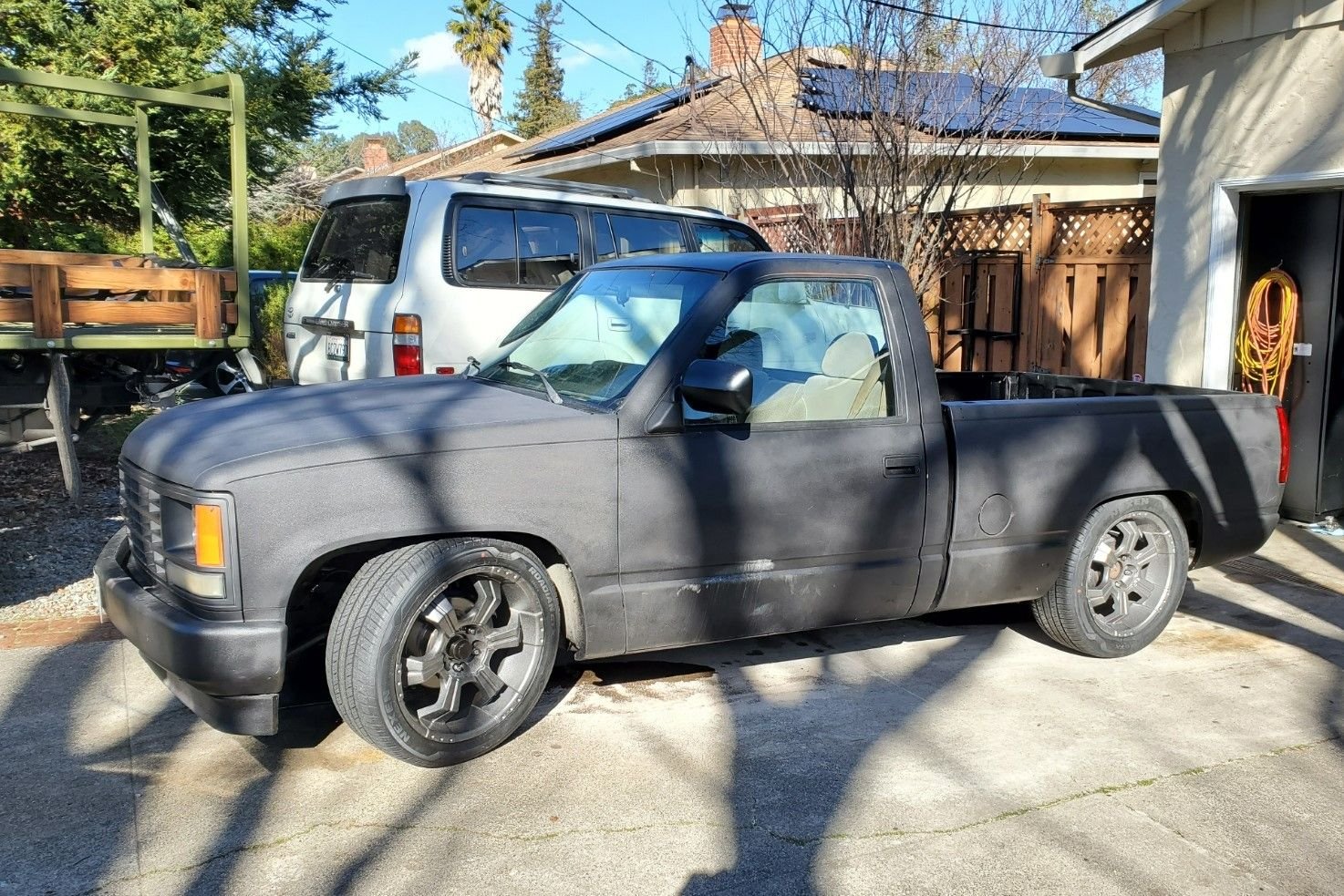

I got the motor running in the truck. I ended up having to drop the flow rate of the injectors way down to get it to run, so I'm thinking I have some bad injectors. Once I get the registration I'll do some street tuning on it with the cam in the current 0 position and then hopefully 2, 4, 6 and 8 degrees so I can make a close approximation of the LT4 cam advance map. Then to the dyno to see what it does.
Old Jan 25, 2021 | 03:57 PM
DaveVAM's Avatar
Joined: Feb 2020
Posts: 17
Motor is in and running. I had a bad MAP sensor and a bad electric pedal so it ran TERRIBLE at first. Now that I have it set to MAF only and Open Loop with a wideband it's much more drivable. I ended up putting a Camaro pedal in and I need to make a new mounting bracket as I'm only able to get 30% pedal travel before it bottoms out on the floor. No fun with a 30% V8...but easier on the rear tires.
