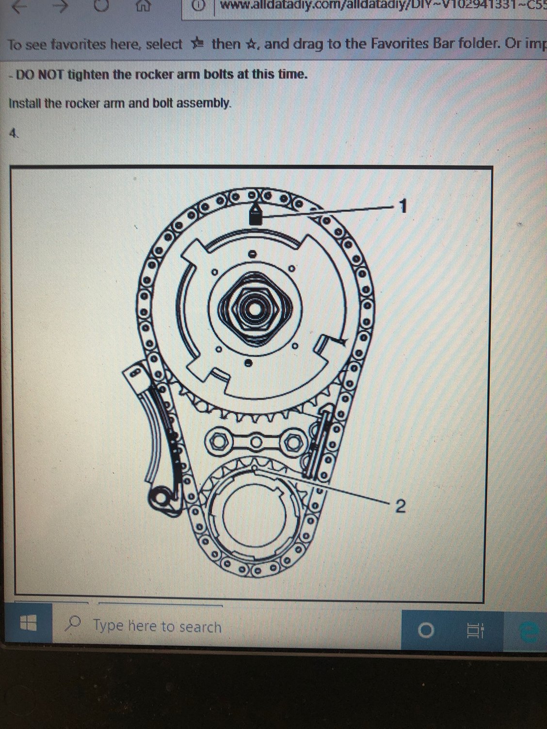

Per all data it shows the timing marks both at 12 o’clock I set the bottom one to 12 o’clock and the top one to 6 o’clock. This is how I’ve seen it should be done online. Can anyone confirm where TDC is?

The cam can be set with the timing gear at 6 or 12 it doesn't make a difference. The cam turns at 1/2 the speed of the crankshaft so one revolution puts the cam gear at 6 and the next revolution puts the cam gear at 12.
