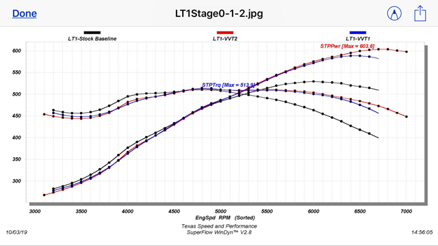

Darth these are the graphs I couldn't send in PM
VVT 1 and 2 vs stock cam
On all cylinders shows the LT1 and L86 cam to have the same specs too. So this would be a good comparison for the truck

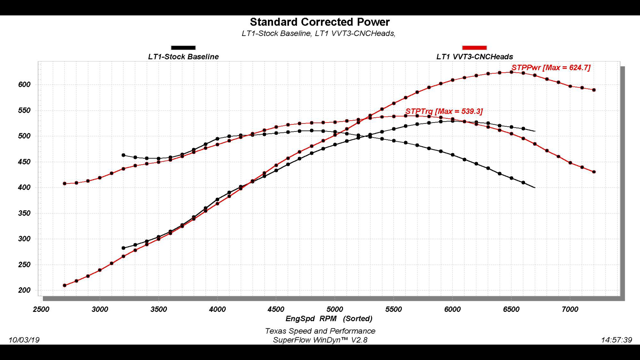

And this is why I would debate the ported heads on my application. This is a larger cam and ported heads, not much more hp, but good gain in torque.

That's a surprisingly good torque curve. And LOL at the title. It's sure to get people's curiosity piqued.
