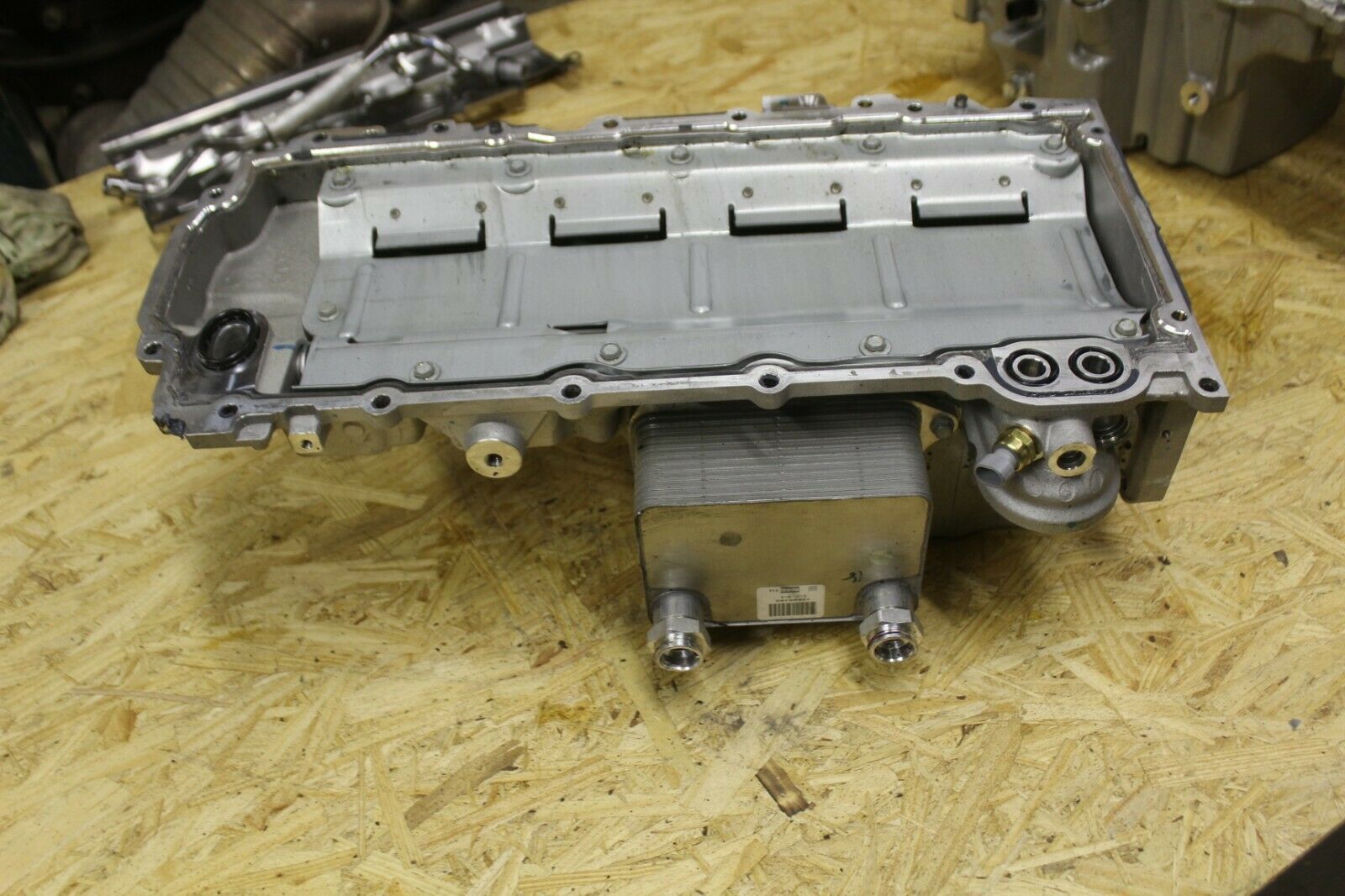

On gen 5 there is no conventional tube or bolt.
The oil pan has a built in pickup and an o ring on the pan that smashes into the pump when you bolt the pan down. That's why you were able to slide the pump back and forth.\
But now the pump will be pushed up by the o ring and may not be down far enough to seal on the o ring.

Here's the inside of a gen 5 pan
