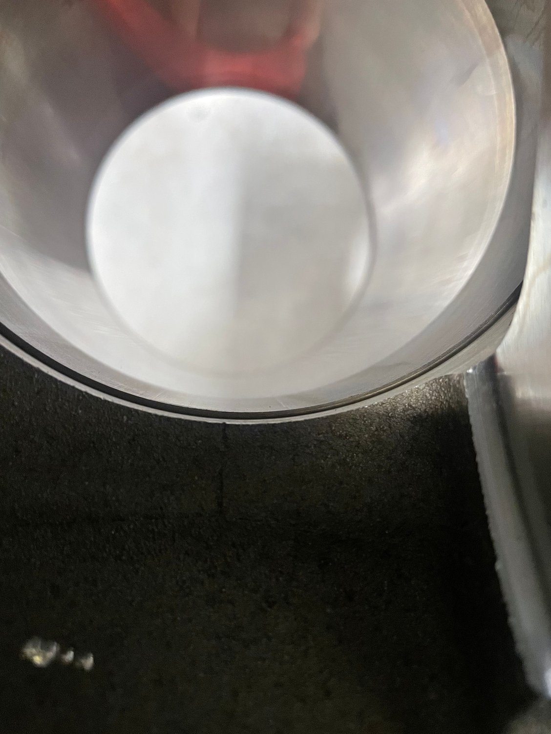

You would have to it sleeved the cylinder liners in them from GM are on the thin side, about 90% sure max over bore per GM is .5mm for service repair. I have a piece of broken liner I can get a thickness measurement for the factory sleeve if you need.

There are two different l84 gen v engines. Some have spray welded cylinders which are very thin. Some have sleeves already. You seem to have spray welded cylinders. I believe 21-present have spray welded cylinders
