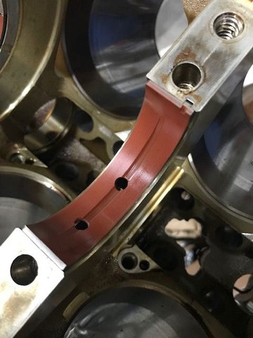

I am getting ready to drop in a forged crank in this Gen V 5.3. I pulled the stock crank out and the mains look brand new. Here is a pic. Would you change these to new ACL bearings or let these run? They all look the same.

Let it ride but check your clearances with the new crank first.

I didn’t know that GM was putting the coated stuff in their 5.3’s. Those are perfect. My only concern would be crush factor, when re-using bearings. If it’s a street build, I’d have no problem with those whatsoever. A big rpm race build would make me think twice however. Once the bearing crush is administered, the upper and lower half mate in that pressed together state. When the caps are untorqued, the crush is released. The crush is designed to keep the bearings from turning in the journal. In theory, the same bearings back in the same journals should re-introduce the crush, but in a race setup, I wouldn’t bank on it. Just my .02….

That's why I ask stuff in here. Always good info. I didn't even think about the crush. I have new bearings here so I will use them---cause I might step on it a few times.
