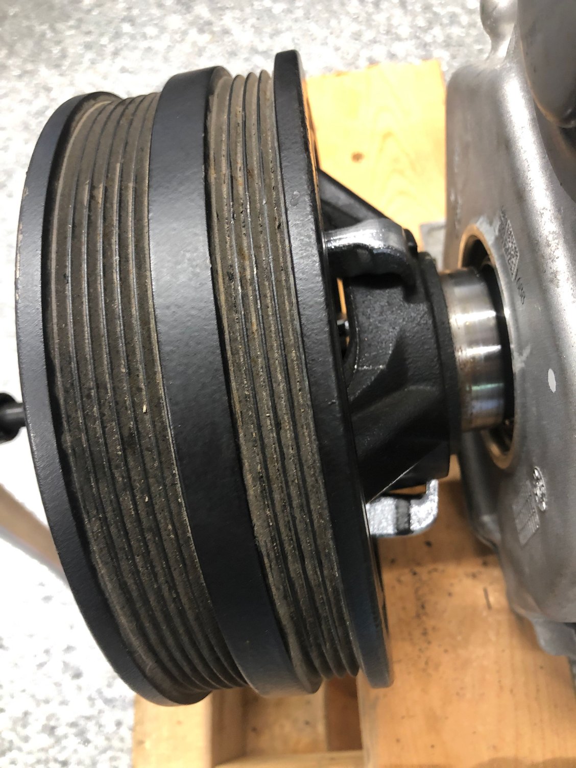

I'm working on a cam swap for my Gen V L87 long block. I've run into a wall trying to remove the harmonic balancer (crank shaft pulley).
I can't get any size 3-jaw puller to work and non of the LS1 pullers will work either. Attached are pictures of the balancer
GM has probably come up with another special tool for this balancer. Or does anyone here have any ideas on what works? I've spent hours trying to come up with a puller that works for this application

This is what the backside of the balancer looks like. There are 3 equally spaced notches cast into the hub.

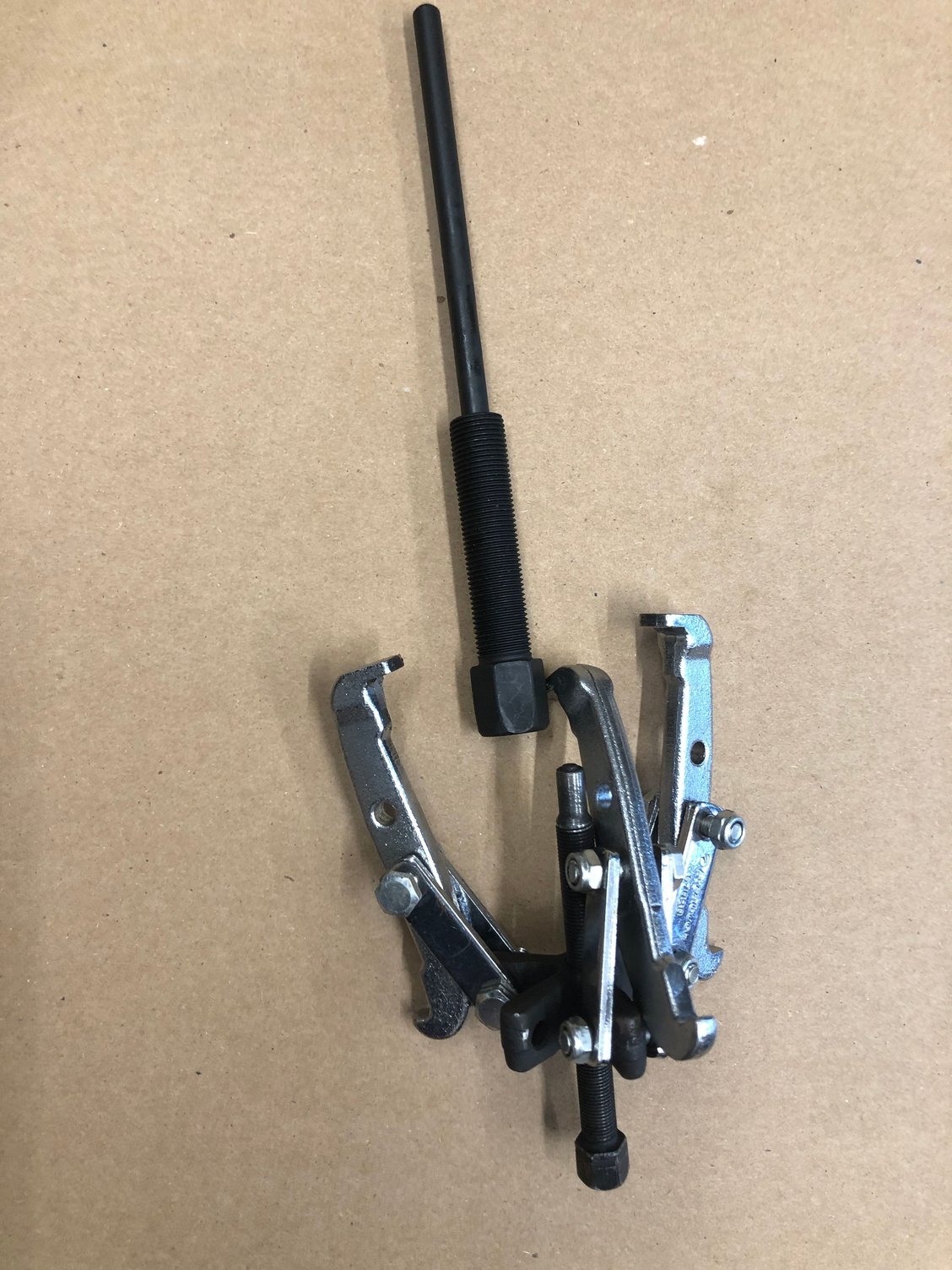

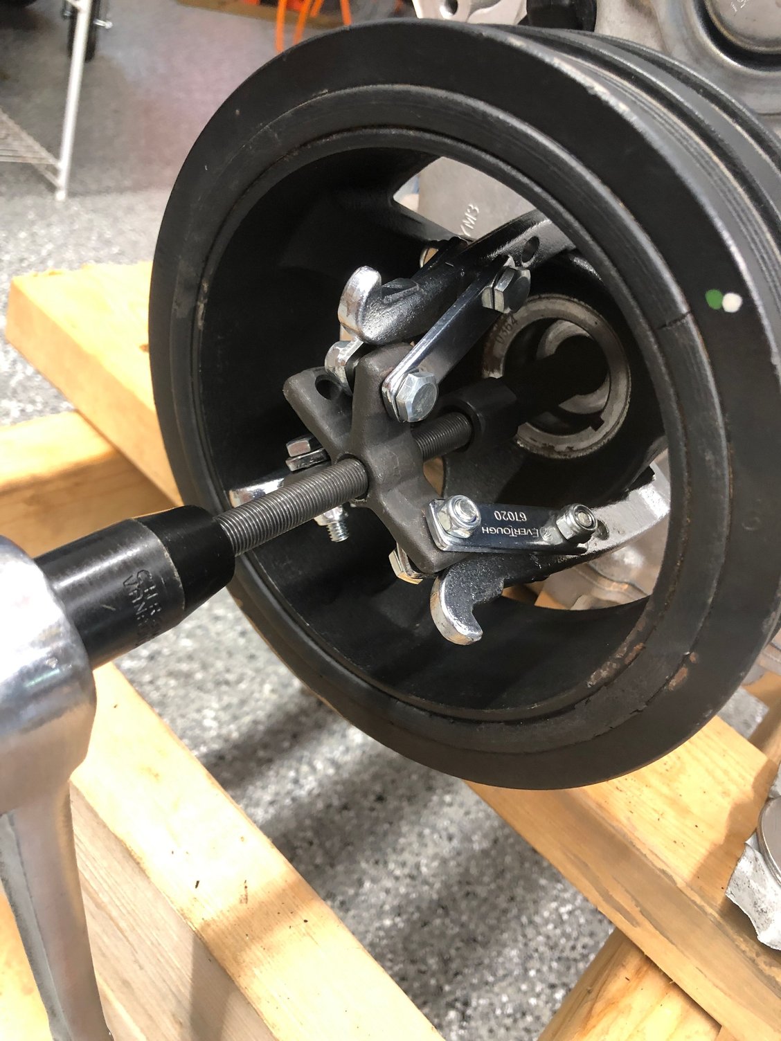

I finally got it figured out. I had to MacGyver together a combination of a small 2-ton 3 jaw puller with a LS1-style puller.

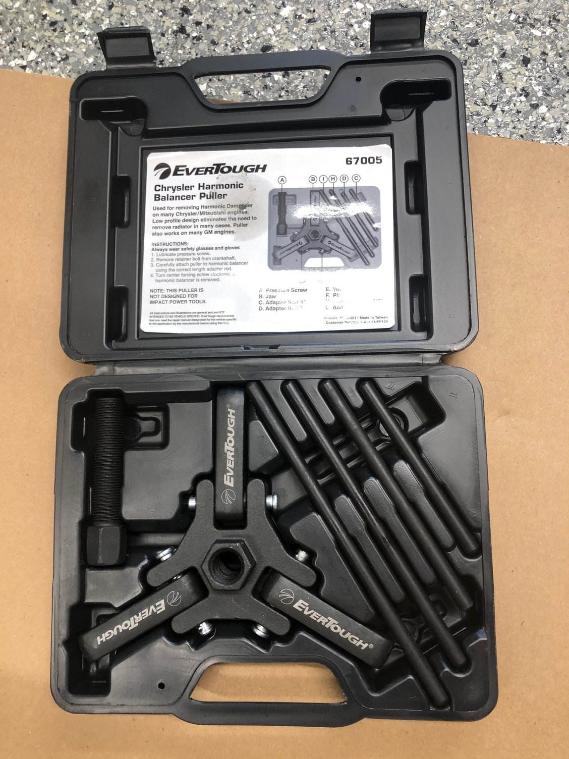

Thank God for O'Reilly Auto's tool loaner program. This is what I used from their tool loaner program:

I attached the 3 jaw puller onto the backside of the balancer. There are 3 small, equally spaced indentations cast into the backside of the balancer that each jaw of the puller fits into. A larger puller will not work; it won't fit inside the balancer. I used a combination of a rod and the ram from the LS-style puller to bottom out inside the crankshaft. The 3-jaw puller pushed against this make-shift assembly.
