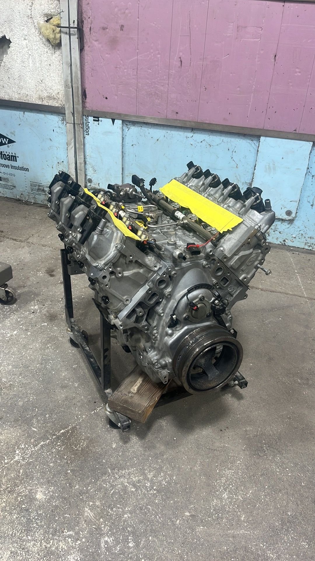

Hi I have a 2015 gen 5 6.2 I rebuilt, bored over .005 btr crank/rods diamonds 1.5cc dome pistons, btr stage 4 vvt cam, milled heads .015 stock stroke, stock fuel. trying to get and estimated horsepower to expect. Thanks

What’s the static compression at now?
Did you check PTV with that camshaft and upgraded pistons? It’s tough todo in a VVT setup, but you need to with that much camshaft in a VVT application.

it should be around 11:8-1 it have the 4 degree phaser in it

.150 of pvc

I’d say your gonna be up around 500-520hp with a decent intake and headers/exhaust system. I experimented with a 2008 6liter engine with VVT, and picked up almost 100hp over stock with a Mast VVT camshaft, LS3 intake, long tube headers, and an unrestricted exhaust. Tune is important.
