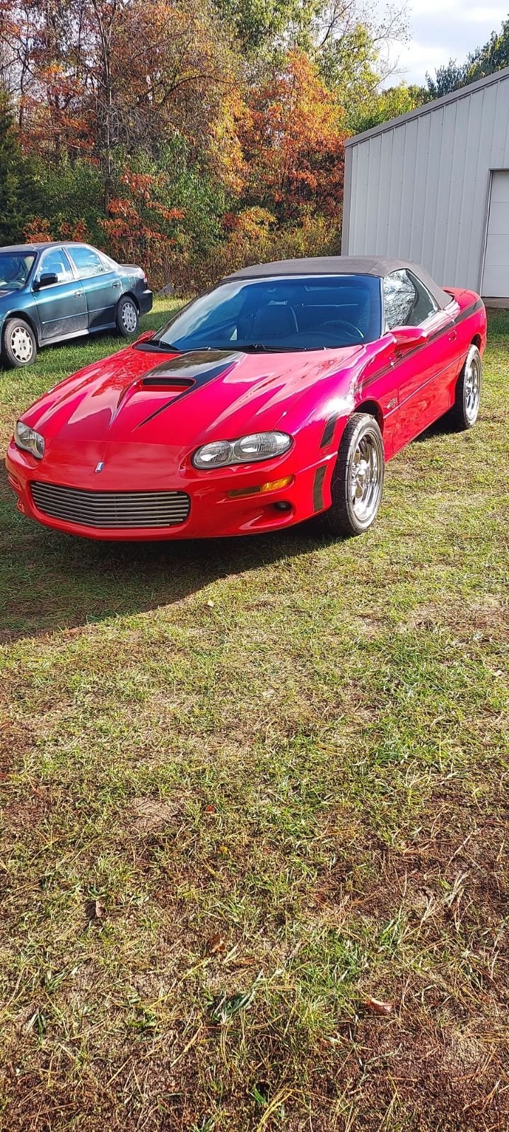

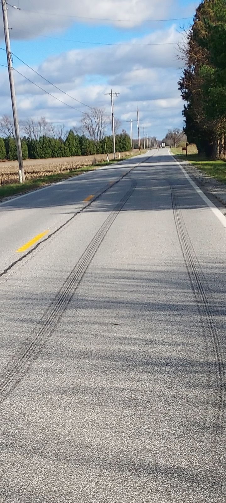

Hello everyone. I am so very happy to be new part of your community. I am brand new to the LS1 experience. I recently purchased a 65k mile 2002 Z28 A4 convertible. The stock performance of this machine is VERY impressive to say the least! The only issue it had was wheelhop. I say had because of the countless recommendations on this site to go with Koni STR.T shocks she now easily lays down silky smooth road stripes. In addition to the new shocks I filled the rear end up with Amsoil Severe Duty 75W-90 gear oil and added a T/A Performance girdle. The car won't be driven hard very often but I figured the 7.5" rear could use a little extra help. Unfortunately the top down season here in Indiana is all but over so it's time to tuck her away until springtime. Thanks again for the excellent forum and Happy Motoring! 😎
