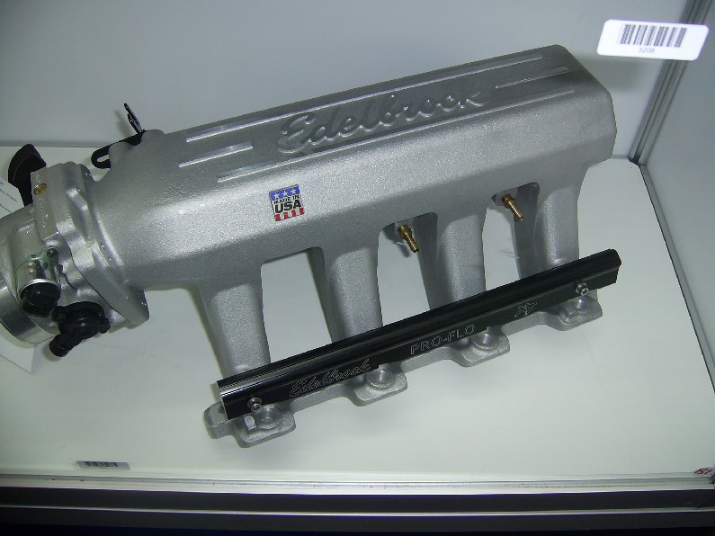

New intake from Edelbrock Pro-Flo XT, this is almost an option.
https://ls1tech.com/forums/generatio...an-fast-9.html

its gigantic. might need a little hood clearance. should fit under my truck hood though...

That thing is huge...reminds me of the LT1 intakes...
Now, go buy it, fit onto your LS4 and get a new side cowl hood....hmmm
Damn transverse engine mount.....
Think when the economy picks up again the parts cos will throw us a bone?

Don't we have a little more room under the hood though? Since V6 GP's will clear the supercharger and intercooler. I was wondering if any of the other available sheet metal intakes for LS motors woul clear that oil plug and clear the stock hood.

Will that intake work on our car?

doubt it unless you want to make a taller hood or drop the cradle and/or mounts some.

where does it say that will even line up.. Most people don't even think of a ls4 when thinking of the LsX family. in the other thread it said that it may come in different sizes for different engines.

If it will bolt on LS1 or a LS2 than it will bolt onto a LS4. The reason I said it was almost an option is because it is so damn tall. But looking under the hood this morning I think it would be pretty damn close.

Holy crap! 9 ½” from the valley cover to the hood insulation on the GXP

it would be on "backwards" but the oil pressure sender probably isnt in the way with that tall of a setup. only other things would be vacuum lines, map sensor, etc. throttle body and air intake setup might have to be changed as well. i would assume this thing accepts a ls2/ls7 so a wiring harness adapter needs to be made for that to work. i made one up but havent tested it cause im spending money on the truck now.
