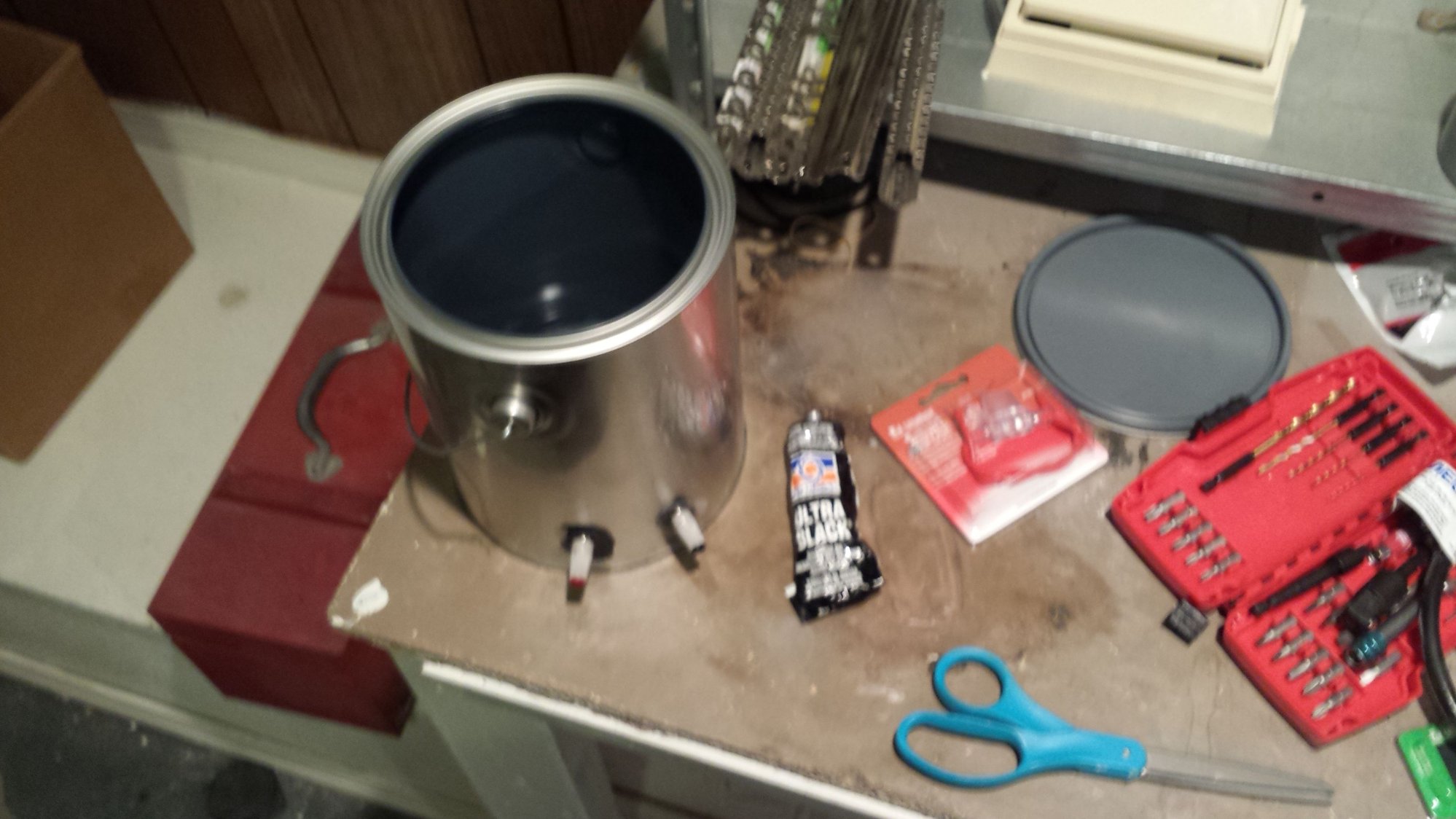

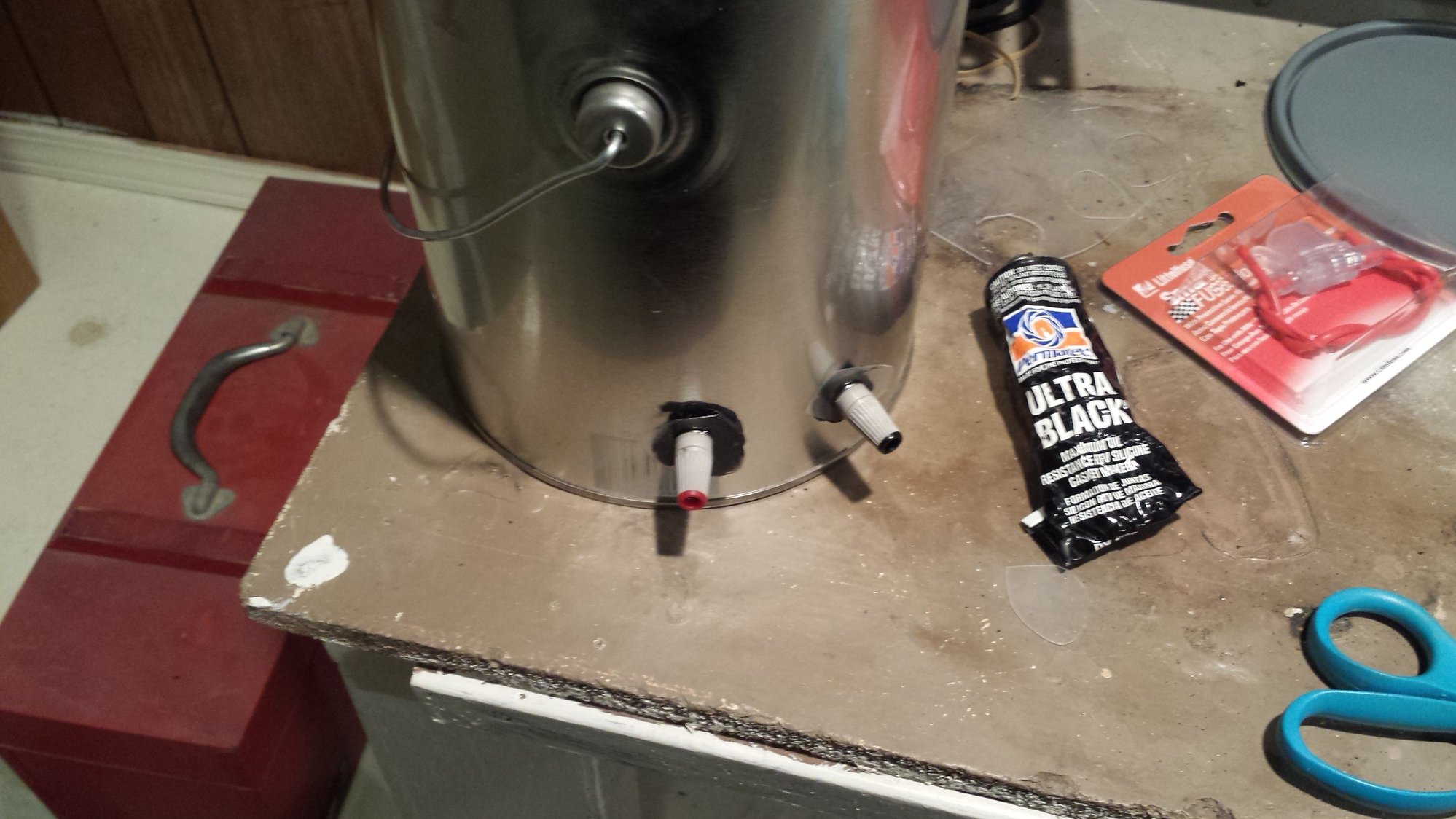

I made a smoke machine because the cheapest one you can buy is 800 dollars or so.
Empty Paint Can - Home Depot
Chromium Wire - Amazon Chromium Wire - Amazon
potentiometer/Dimmer for DC curren = Amazont potentiometer/Dimmer for DC curren = Amazont
1 PSI BBQ Regulator - Amazon 1 PSI BBQ Regulator - Amazon
Some other parts that are easy to find was Insulated terminals , Wick , and the air fittings.

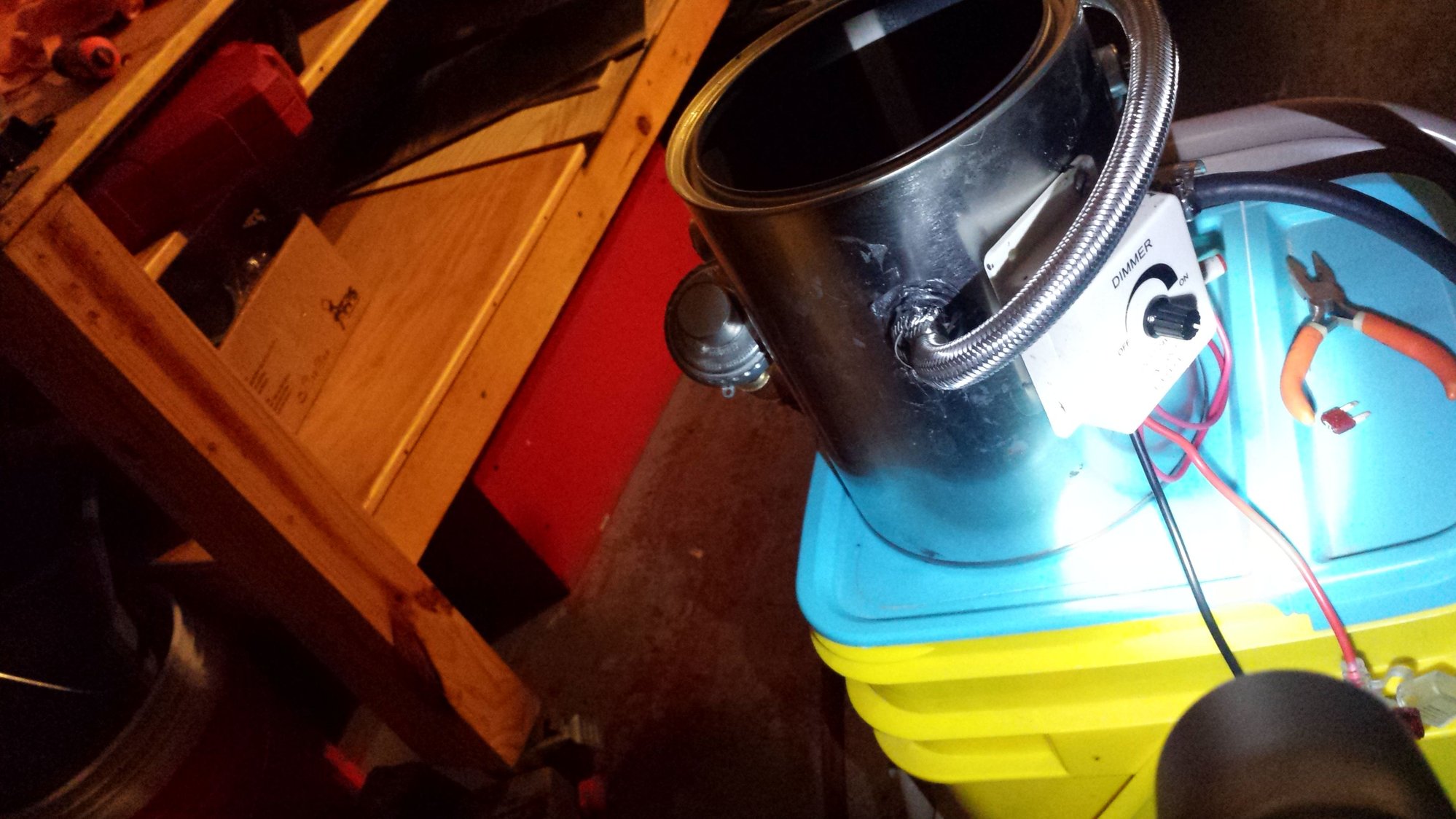

Completed , air regular wrapped around can

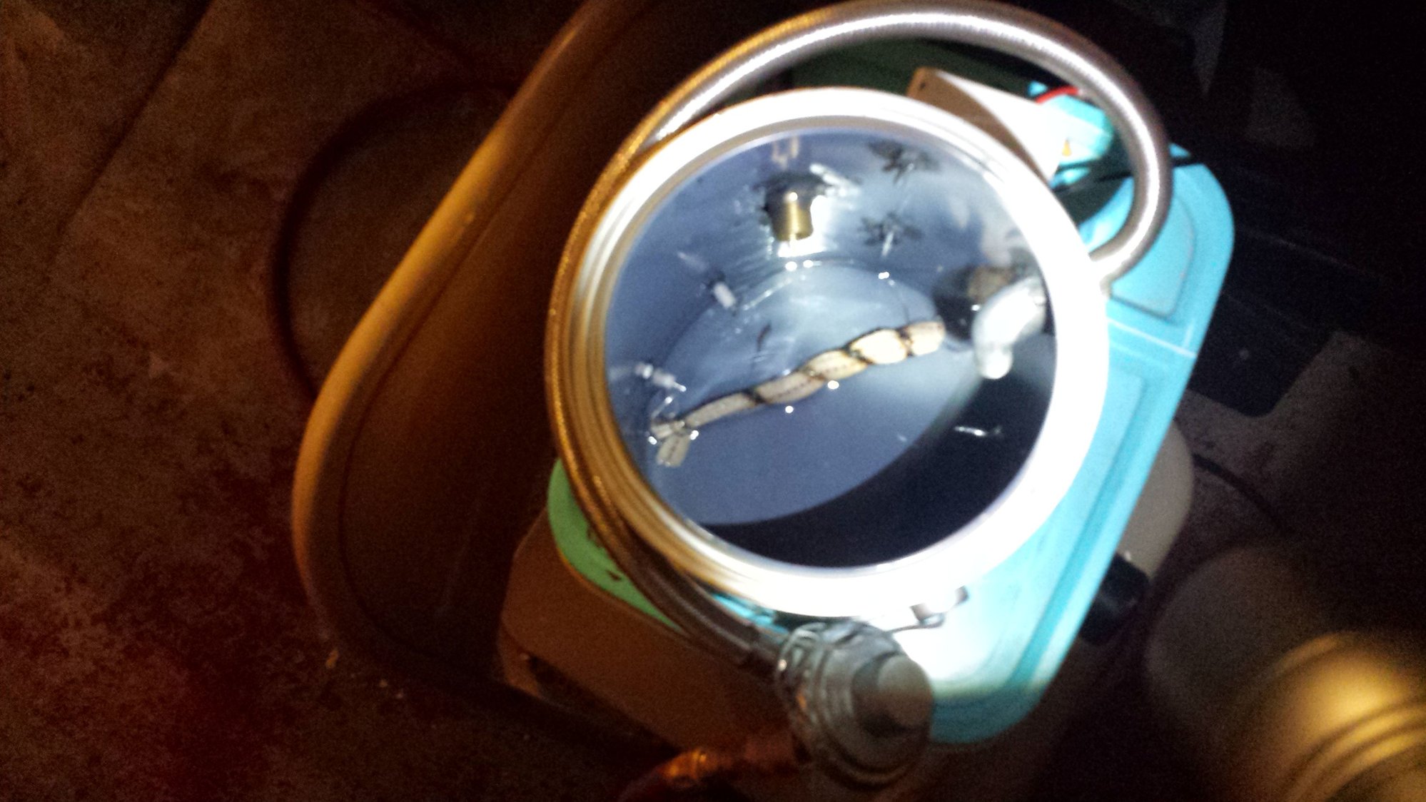

The Chromium wire wrapped around the wick connected to the terminals

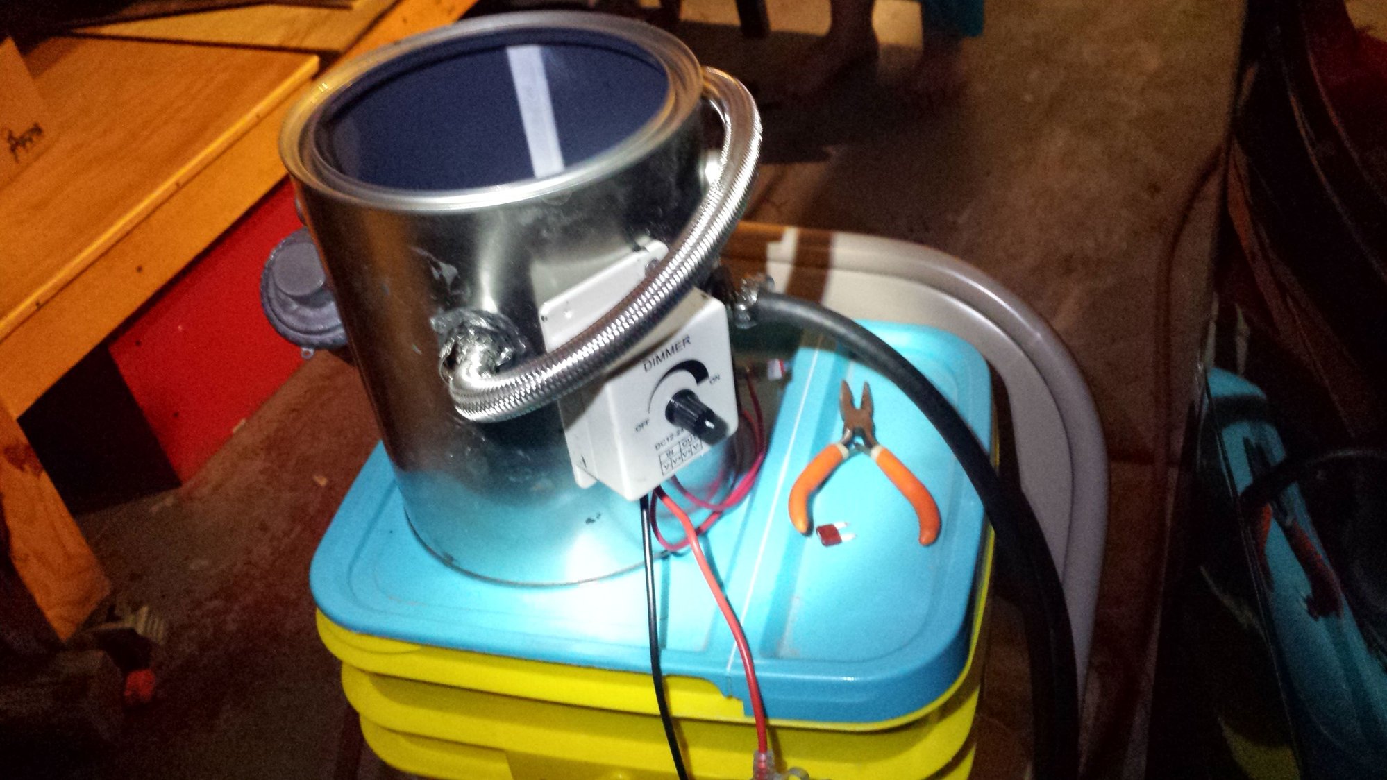

The Dimmer switch to raise lower the current
Dimmer switch raise / lower ccurrent

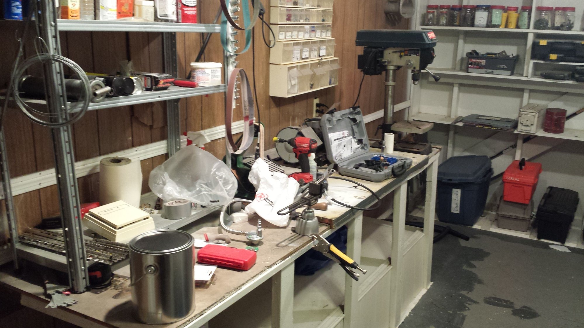

my 3rd floor little shop/work area
This thing puts out amazing amount of smoke, i could not ask for anything that works any better. I'll add some more photo's tomorrow when its daylight out if anyone else wants to see.
