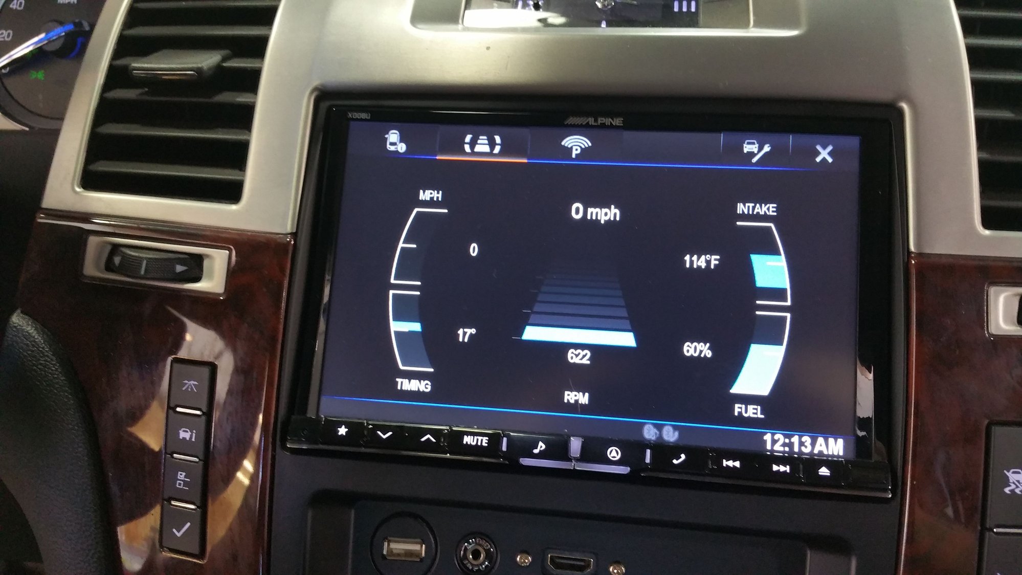

Mastro in action in a escalade

Sweet Baby Jesus! I can have a head unit like that for less than 200 bucks?!?!?!?!?

More like 2000$$$ But that's top of the line it can be had for about 500 with a more entry level head unit
