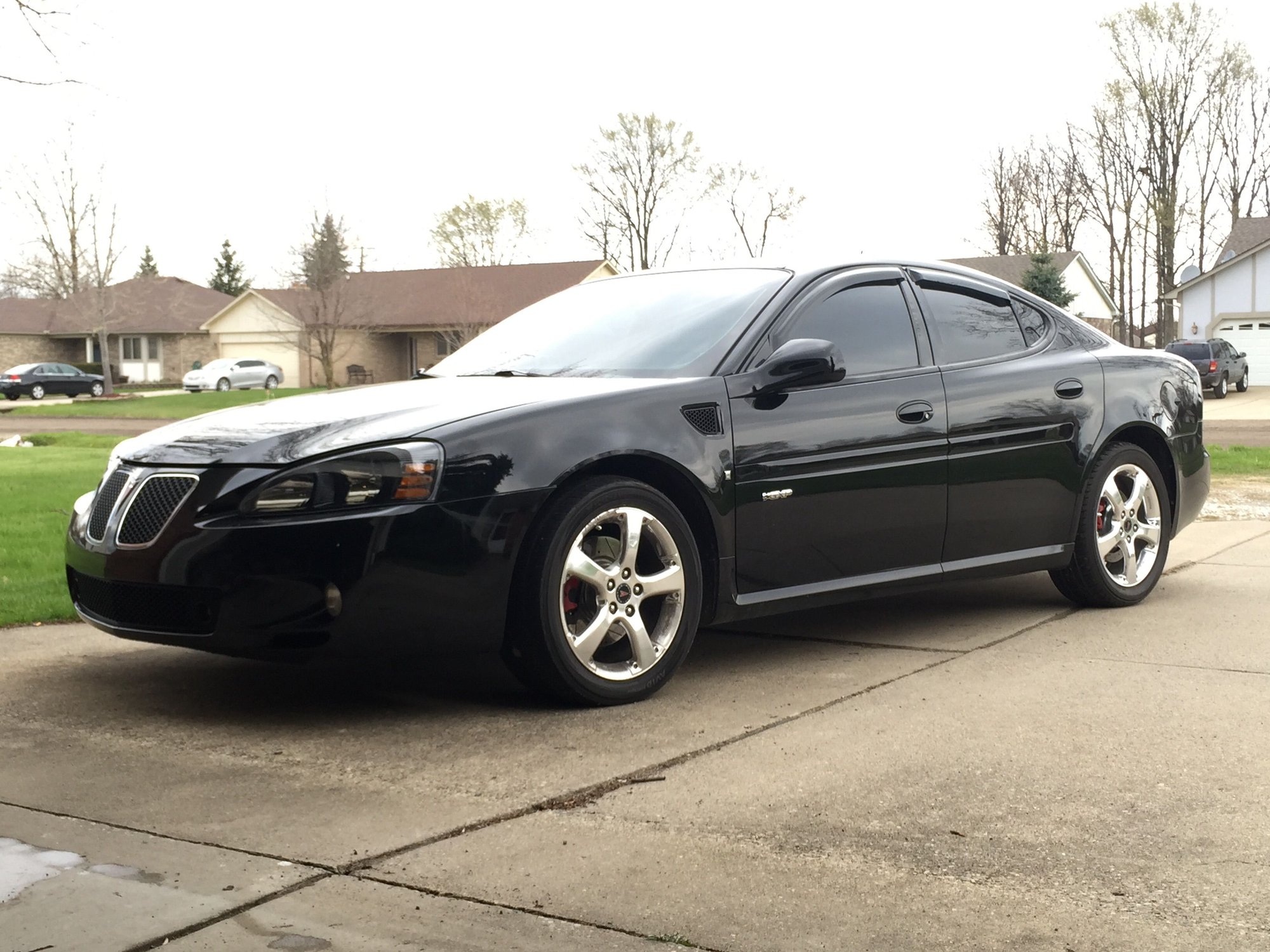

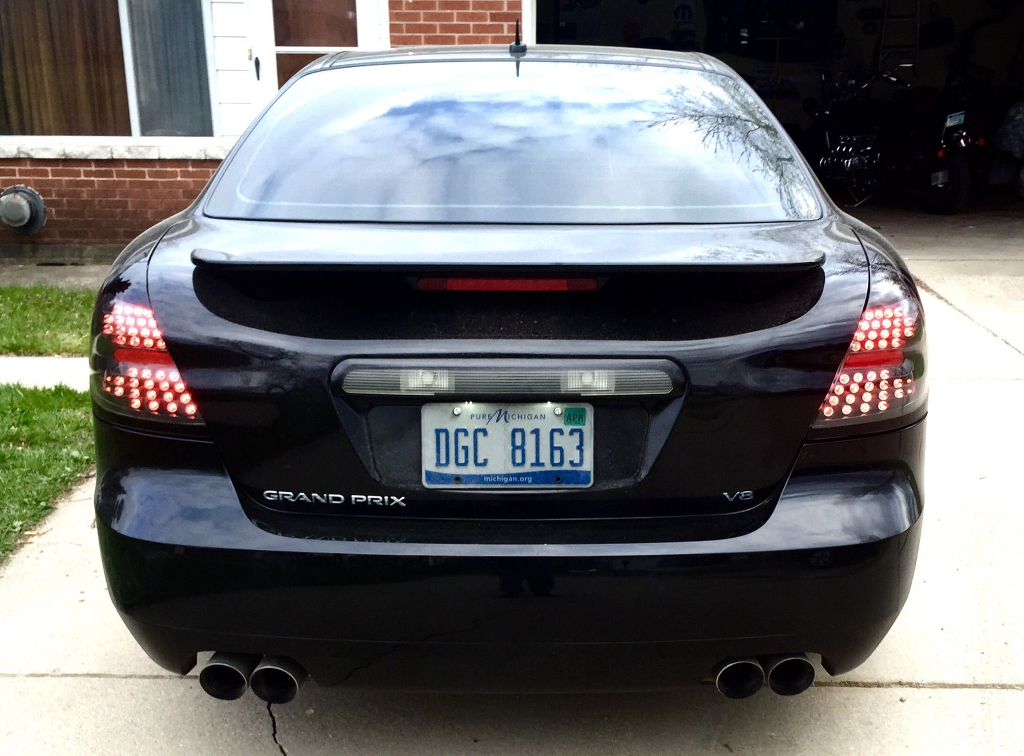

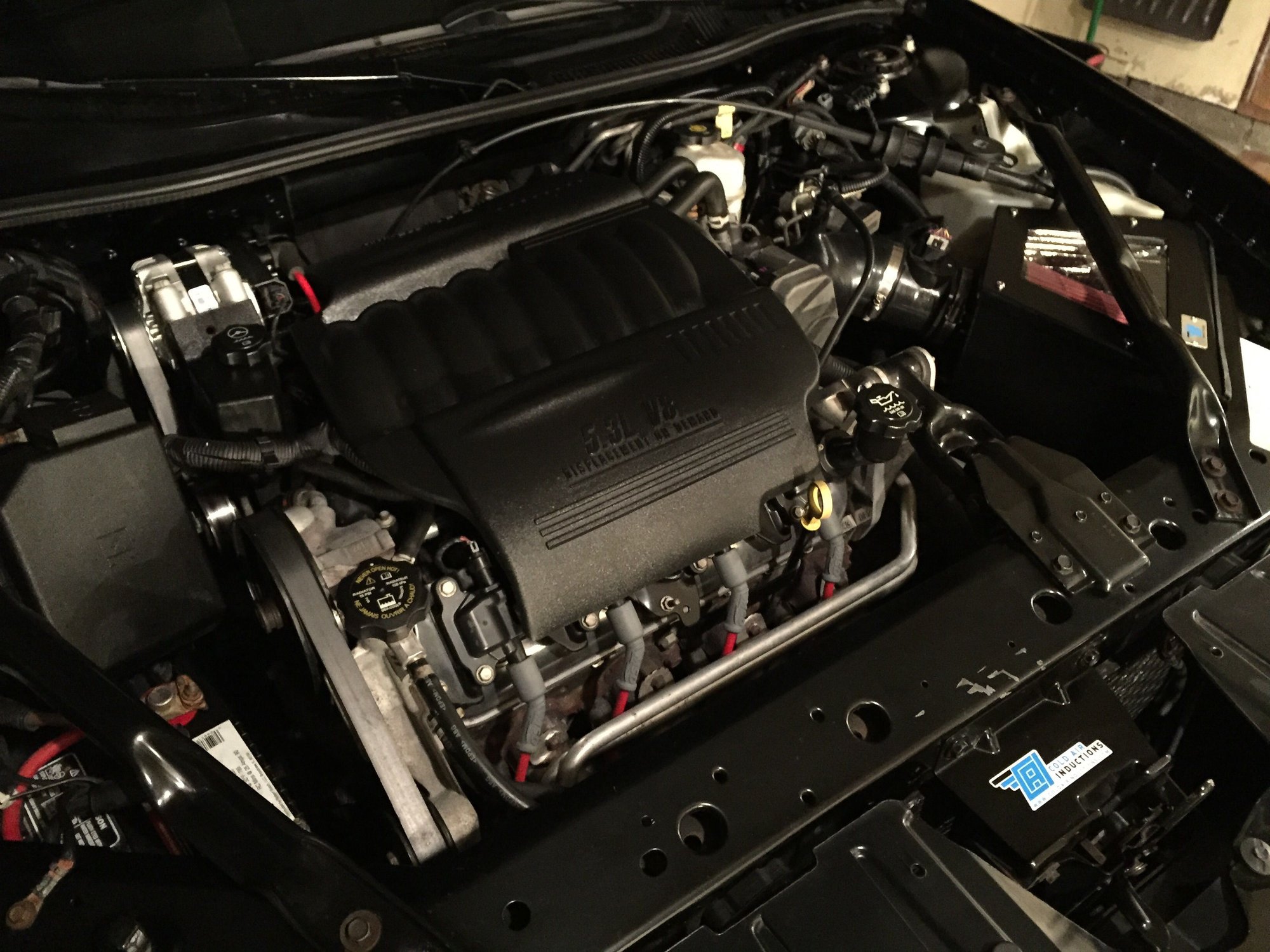

All in all, progress is being made, but still much work is still needed. On the bright side of things, I have added a few goodies to it, including a cold air inductions intake system, LED tail lights, NGK plugs and MSD wires, new alternator, drive belt, and GXP embroidered floor mats to compliment the interior. Im pretty happy with how she's coming out, and now I'm itching to get my exhaust done lol. I'm going to be needing front tires first, the road noise and uneven wear is killing me. I'd appreciate any advice/pointers you guys have to offer to make this project go a bit smoother, I really do like my GXP, I just want to enjoy driving it without the minor inconveniences haha

i got same car as u except yours looks a lot cleaner than mine and love those leds my mod after intake swap

Haha thanks man, I detail it whenever it's not raining here in MI. I spent a lot of time pondering the thought of to tint, or not to tint. It was a PITA to get it perfect on my last car, so I figured the LEDs would look cool without having to mess with spray, and I would have NO issues with brightness lol

I'm going ls1 with throttle body I'm having the oil press send unit cut and welded now so ill post pics once it is on
