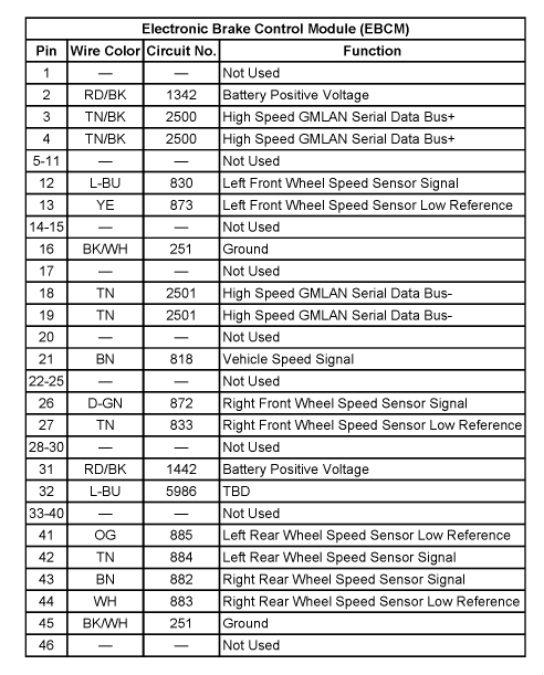

I'm not a fan of throwing parts at things like that either. But, with computers like this is can be difficult without the correct tools. If you have a multi meter you can check the outputs of all the wheel sensors, you can check the bus lines to make sure they are communicating. You can make sure the EBCM has ground and power.
The best way in my opinion is to back probe the connect, some prefer to pierce the wires, but i only do this in hard to reach areas. If you do make any holes into any wires, fill them in with clear silicone sealant.
