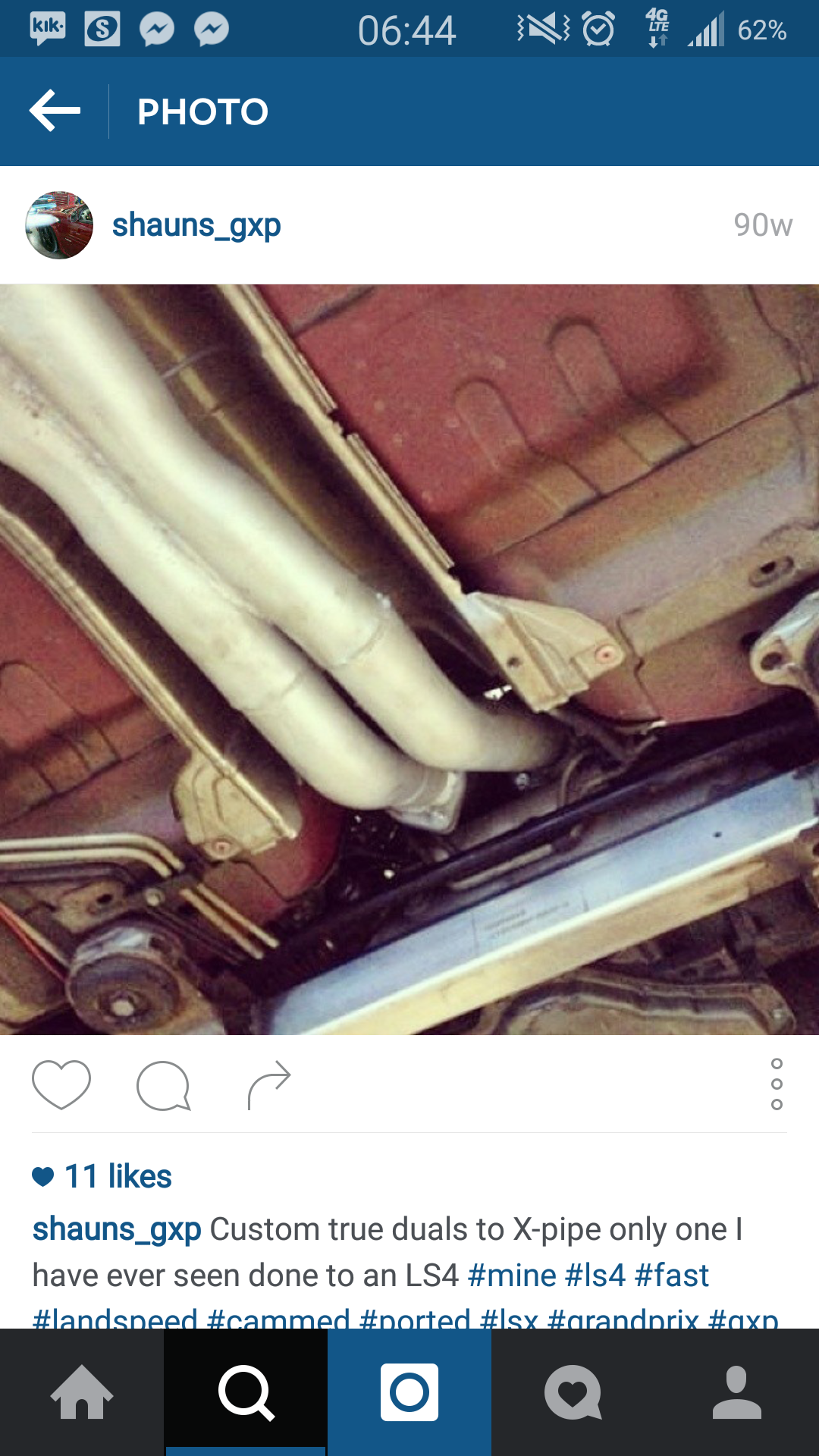

Shaun daddo has a full dual setup, but the concept is the same have 3bolt flange welded at the ends where that part is and never have to deal with it again, or a quality vband

From: Arizona
Old Mar 7, 2016 | 06:14 AM
superglide9375's Avatar
Joined: Oct 2013
Posts: 611
From: hagerstown,md
uh o ,i like that,want true duals!!
