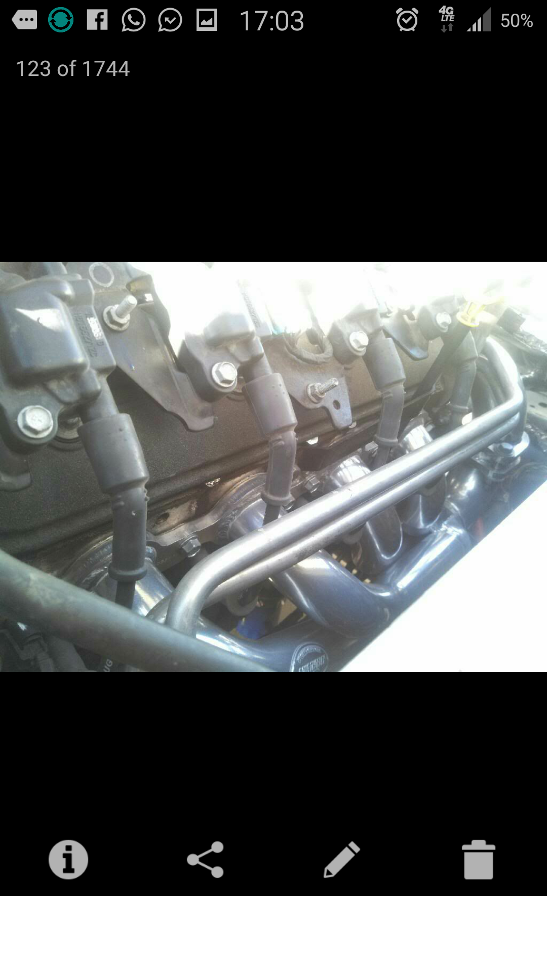

Old Mar 5, 2016 | 04:10 PM
spawne32's Avatar
Joined: Jan 2014
Posts: 1,524
Originally Posted by Mike The Canadian
Thanks dude - where did you're leak end up being? Any areas that I should worry about leak wise?
Mine was and still is at the rear header connection, because of how ****** impossible it is to properly access that section once installed. The original "band" clamps that they give you are junk, toss them immediately, you want a "lap joint" style band or something that compresses around those two intersecting pipes and seals over a wide area and provides even pressure. While ubolt clamps are fine at tail sections, they will leak up front.
You can see here i was able to change mine out with a u bolt and get it tight but it relies on a pressure seal rather then a physical seal. Look at that clearance, ugh.
Old Mar 5, 2016 | 04:43 PM
91parkave's Avatar
Moderator
Joined: Feb 2008
Posts: 2,079
Likes: 9
From: Arizona
Quite possibly the most retarded header design ever.
