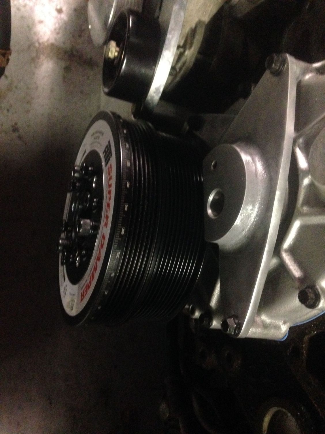

Figured the setup would raise an eyebrow or two
Ill post up some more info when I finish it... but it's a reverse drive Novi blower (from a c7) and the intake started life as a edelbrock pro flow
non intercooled running E85 (actually around E68 year around in my parts of the woods)
pic above I dis a custom setup... using the ATI big block hub and universal 10 rib pulley I decided to position the blower pulley BEHIND the ATI damper
IMO the lever arm for extending the blower pulley on the crankshaft puts a lot of undue stress on the crank/mains, is with a reverse drive you have much better inlet options and usually a shorter belt which all helps

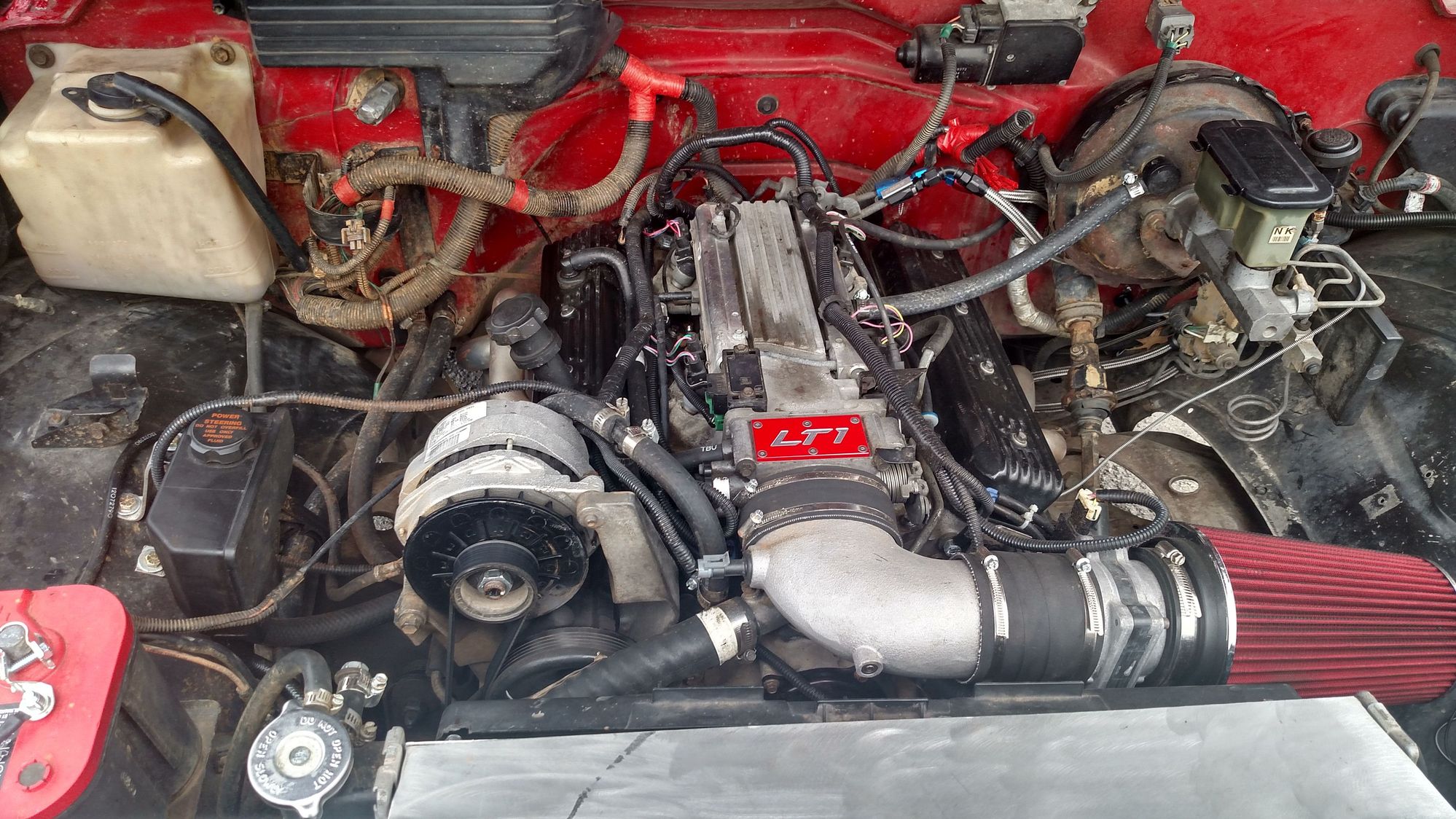

LT1 swapped 1994 Chevy Cheyenne
