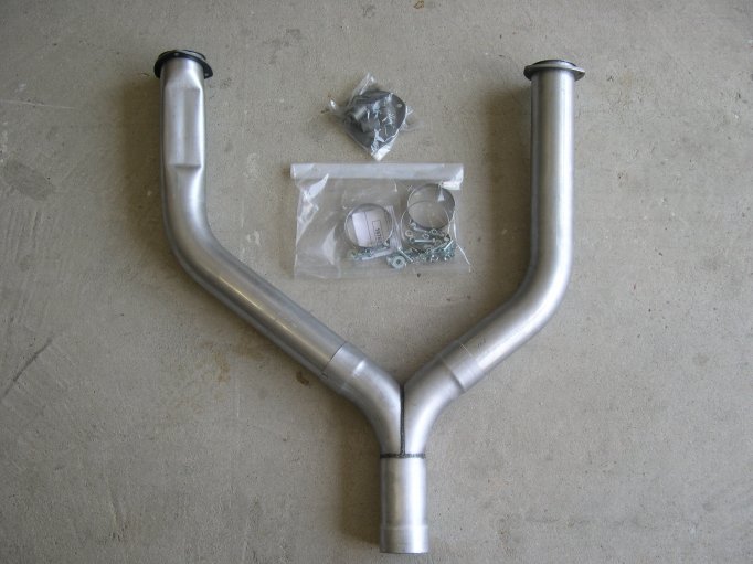

I am thinking to go this route:
From currently having something like this:
Can get one made with prob four 3"x45* bends and some 3" straight pipe.

That merge looks no better than the typical ORY. These look much smoother.
Old May 3, 2014 | 08:31 AM
n2oblkz's Avatar
Joined: Mar 2004
Posts: 996
From: Versailles, IN
I think that's the Y pipe offered by Hooker, which I have on my car. If you look at the inside, it's a very nice merge and Y pipe.
Yeah, sorry, I was in a hurry and quoted the wrong pic. I meant that the top one here is what I have, which is a Hooker, it has a nice merge. The other is a Flowmaster.
