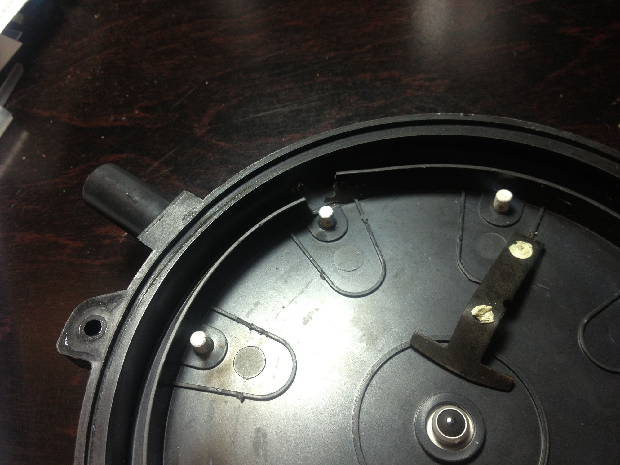

Carnage Pics! Let me know what you guys think. Also, the rotor screws were kind of loose, the rotor had some play in it. But I think this may have been caused by the internal collision.
Also, now you will see what I meant about there only being one vent line. the opti is vented but the cap is not. And this vent was hooked up to the DS intake manifold. There is a check valve on this line and it is installed with the blue side to the opti, white side to the intake manifold.

So I just pulled the vac line from the intake manifold and tried sucking on it. It was very difficult. I fliped the restrictor around and it was very easy. So i think i have that part installed correctly. Also, looking at the marks in the pin drive area of the failed opti, it looks like marks from the dowel go about 75% of the way down into the groove which leads me to believe that the dowel is the correct length. I hate to pull it apart just to confirm that
