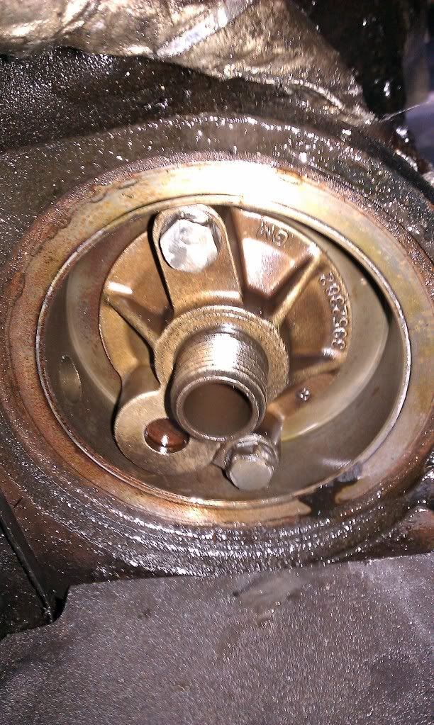

You could remove the oil cooler to see if that helps.
You'll need to loop the coolant hoses together.
It'll look like this when it's removed:
