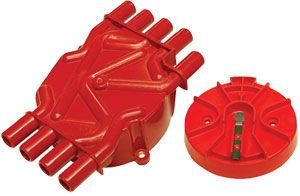

Back in the day, Standard Motor Products offered almost any cap & rotor in their upgraded Blue Streak line. They make a Blue Streak rotor for these engines but not the flat cap.
Accel makes a pretty decent cap with brass terminals and hollow rivets for the hold down bolts and it's available at AutoZone.
Today, the best cap & rotor for this (V-8) engine is from MSD, part number 8017.
You can get zero ohm wires from the good folks at Granatelli Motorsports.
This was my setup on my 4.3 S10. It ran best with the Accel cap, Blue Streak rotor and Granatelli wires. Strangely though, it killed NGK spark plugs. Swapping to the "correct" ACDelco plugs cured that problem.
