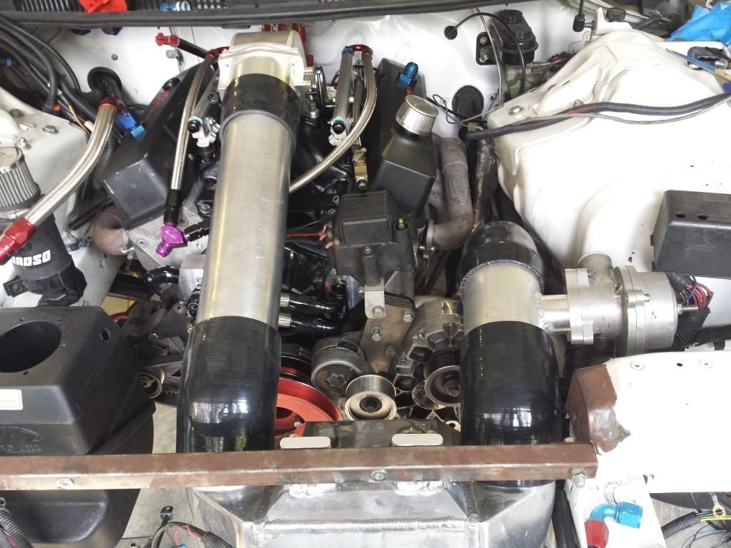

Originally Posted by ozfromboz
anyone retaining a maf with a single plane set up or is eveyone switching to SD tunes ?
SD but MAF is there for ***** and giggles.

Old May 1, 2015 | 11:14 AM
ozfromboz's Avatar
Joined: Nov 2013
Posts: 17
Very nice set up .. exactly what im lookin to do .. what did u use for throttle cable and TB shownomercy ?

Old May 1, 2015 | 12:58 PM
Shownomercy's Avatar
Man-Crush Warning
Joined: Jun 2009
Posts: 3,197
Likes: 130
Ultra low profile elbow from edelbrock (its a POS) and a 90mm from edelbrock (its less of a POS)
Throttle cable is a stock LS1 non traction control one, I think.
thanks for the info .. any combos similar in height with pieces that you wouldnt consider to be POS'S ? LOL .. i already have a 58 twin but like the look and idea of the single blade Ls style tb .. what did u use for your intake tubing ..? any chance u tried to fit a stock style cai .. like a moroso set up like i have ..?
Yea mine would bolt up to a stock CAI, just would need to fab up the elbow. The ultra low elbow is pretty horrid if you have a NA motor, it flows like crap, but it fits under stock hood. Win some lose some. I would like to switch to a taller elbow and maybe another spacer under it.
The hood will be the first to hit, I have that elbow and a 1 inch spacer under it and plenty of cowl clearance.

FWIW I can verify that a Supervic(1" taller then vic Jr) and an 860 performance or intakeelbows.com elbow will both fit under the cowl, and if you don't mind trimming some plastic you can also squeeze a 1" spacer in there too.
The intakeelbows.com piece is a killer elbow but will be hard to find since they stopped making them, but I think nitrousoutlet will still do the 860 elbows on a made to order basis. The 860 leaves the TB in the stock location so normal CAI's will bolt right up to it.
The low profile one Shownomercy has really is a POS for NA builds, he wasn't lying . Probably not as big a deal when boosted like he is, but I recall a stout LS build gaining something crazy like 40hp just from switching from that low profile edlebrock to a full size elbow. The air has to make a crazy sharp turn with it.
Its retarded, **** expects air to magically flow up, then make some sharp *** bend down and then into the intake. Its on my list of things to replace as soon as I get some more money and the thing is running 100%. As a boosted motor, I could give a **** about it for now
