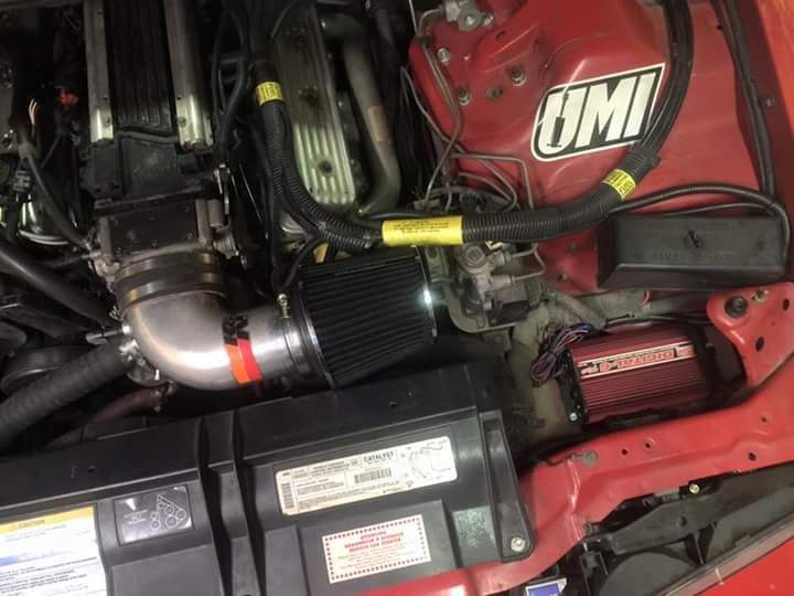

Is that a electrical conduit fitting....?
da faq.
Good way to trash your pistons when that nut comes loose.

It may be close to the same area, but I logged it WOT first gear with the tube and without:
Baro for both was 103.7
Readings from 6000rpm
with tube:
Map 98.2
AFGS 240.5
Without tube:
MAP 101.5
AFGS 257.58
da faq.
yeah, you like that huh!
lol
that's how it came.. it never really bothered me because i figured if it did come off it would stop at the maf screen.
Still, wtf. it's just a big damn hole that you have to find a cap for.

I noticed a jump in MAP readings too after I ditched the ebay piece.

LOL good eye didn't even see that. Wow

Lawd Jesus help me
