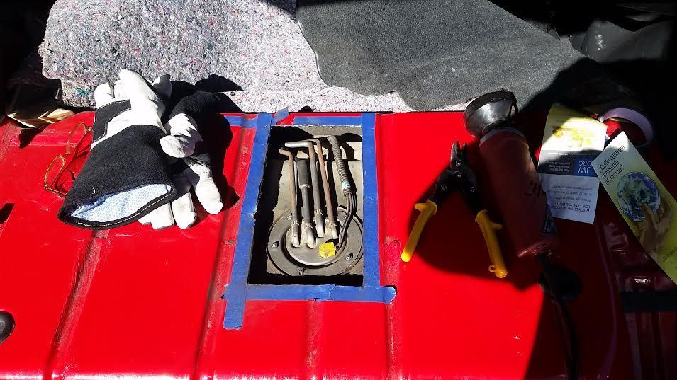

I have a 96 firebird ws6 and am looking to cut a trap door in order to replace the fuel pump. I was mainly looking for measurements/dimensions on where to cut. I have a cut off wheel to cut into the trunk and a piece of sheet metal to cover it back up for whenever I am done. Any advice is appreciated.

A few members have done write-ups, was looking for one by 95RamAirTA but couldn't find it. Here's one, also with pics from another member:
https://ls1tech.com/forums/lt1-lt4-m...-mod-pics.html

that is the thread that I used when I did mine, except I ended up cutting out a little more to have better access to the fuel lines

Old Oct 20, 2015 | 01:43 PM
SS RRR's Avatar
Village Troll
Joined: Oct 2002
Posts: 11,111
Likes: 598
From: Jackstandican
Don't use a cutoff wheel. Use tin snips. Much cleaner and faster.

I used a cutoff wheel for mine and it wasn't too bad. I took my time and did shallow cuts to keep the sparks to a minimum. it was a little nerve wracking, but went smoothly and I think the cut was very clean. if you are nervous about making sparks above your gas tank, use tin snips, but there is nothing wrong with a cutoff wheel

be very careful on the side cuts the tank it just under the sheet metal, like a 1/2"

Very nice. Thanks fellas. I was thinking about using a cut off wheel but I'm not too great with it so I will be using tin snips. Did yall just use a piece of sheet metal and rivet it in for the cover up?

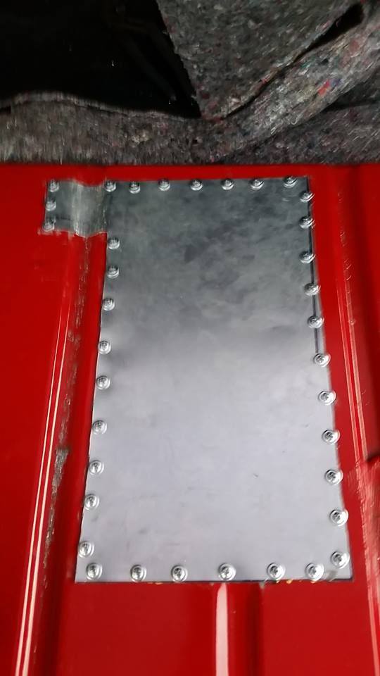

Thanks for all of the replies. I got my trap door cut with the measurements provided.Thanks again yall.

Here is my work

hokeyplaya05 how did you end up rolling your metal to cover up the corner where the fuel lines are? I am looking to do this myself, just don't know whether if I can do it with some vice grips or if I'm going to need special tools for it thank you.

Here is the finished product. Thanks for all of yalls help.

nice, looks almost exactly like mine lol good work
