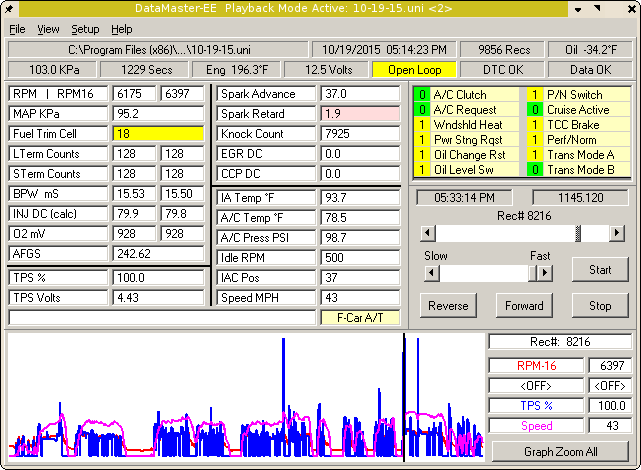

Been trying to tweak my shift points, did a data log yesterday of a wot run through the 1-2 shift. Rev limiter is currently set at 6130, yet the logs show the engine going higher than that, plus I'm confused between rpm and rpm16. I never hit the limiter, it shifted quick and clean.
Here's some screenshots
Notice that engine goes to either 6375 or 6397 depending, shouldn't it have hit the limiter? or is it not accurate?
Also, anyone think I may have an intake restriction? Or is that drop in map normal?

Does anybody know why the rpm showing is above the rev limiter when I didn't hit the limiter?
Anyone else experienced this?
It's just a bit concerning seeing it showing almost 6400 rpm when the limiter is set for 6130.
