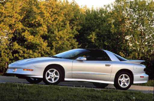

If that's your trans am, it looks lowered already.

Well I was like half on the side walk. Haha. But my goals is to get to 350hp+ somehow. Budgeting, not exactly because I don't like to get what I paid for ya know. Also kinda but one part at a time slowly but surely.

I see it's hovering a curb, I wasn't referring to that. I was referring to the wheel gaps. Look at this picture of a Stock Trans Am, check out the wheel gap, compare that to your's. Big difference.
