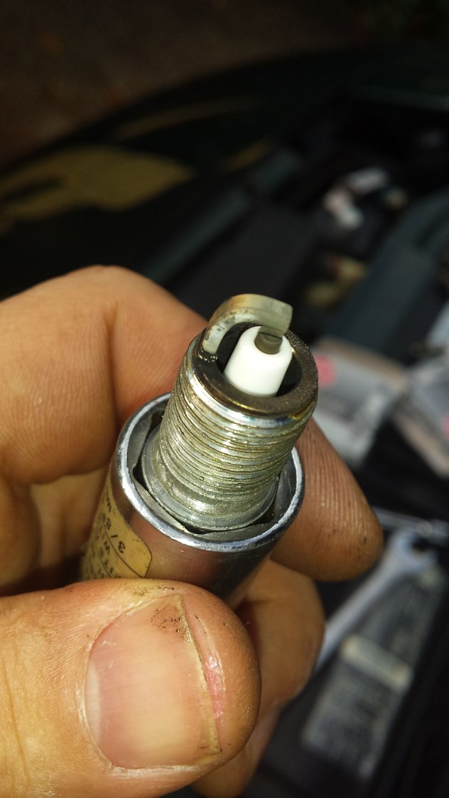

That's what I'm worried about. Last time I went to the track my afr jumped to 14:1 at around 6k. Thinking it's not keeping up with demand. It would also explain why I had to fatten the mixture up top to get a good pe afr.
The thing that I don't understand is my idle afr. I seem to be getting a false rich condition. All my googling has yet to turn up anything that would cause this. Narrow band sitting at around 1mv at idle, wide band normally drops to 11:1 or lower when it's fully warmed up. Worse after it's run hard. It had actually dropped down to 10:1-9.9:1. It was just idling away. Not possible. So I pulled the plugs. Here's #7
Rest of the plugs looked pretty good. This was the leanest cylinder.
Wth can cause a false rich condition?

I let the car idle for a while with the O2s pegged out reading rich, then pulled that plug, obviously not running rich. It's open loop anyway, just trying to figure out what would cause this.

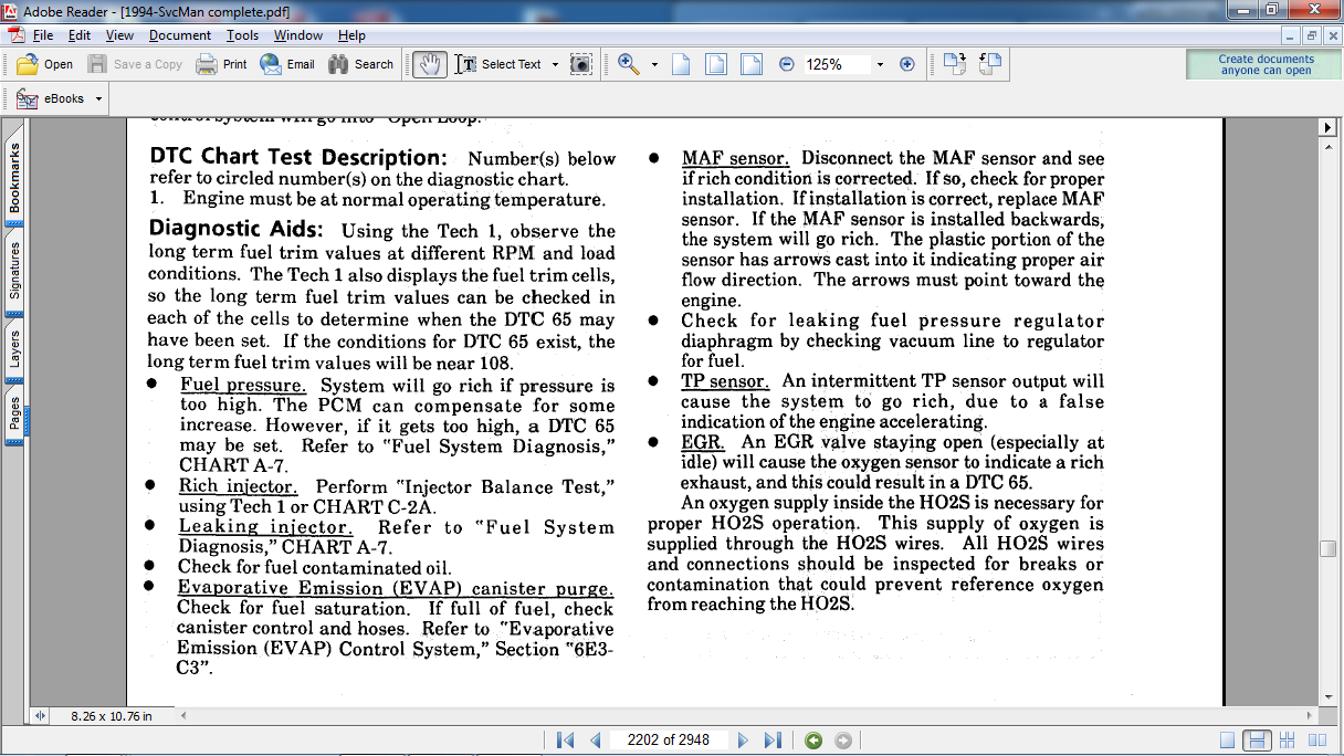

ACE1252's Avatar
Joined: Jun 2013
Posts: 853
Likes: 32
From: Kernersville, NC
I've been reading through the '94 service manual for a rich condition as indicated by the O2.
Here is what the service manual states to check in the below picture....the EGR valve stuck open at idle is one issue I had not considered....
It also makes reference to disconnecting the sensor from the wiring harness, grounding both the O2 signal wires(not the heater wires) and looking at a scan tool to see if the indicated O2 voltage is below 0.35V. This is testing the PCM inputs to make sure they are not somehow locked into a permanent "high". Due to external wiring issues or PCM input failure.
We really need to see a full scan log of what it's doing with close loop enabled.....warm it up in open loop, then enable closed loop and do a full log of the engine inputs and outputs for a few minutes at idle.
