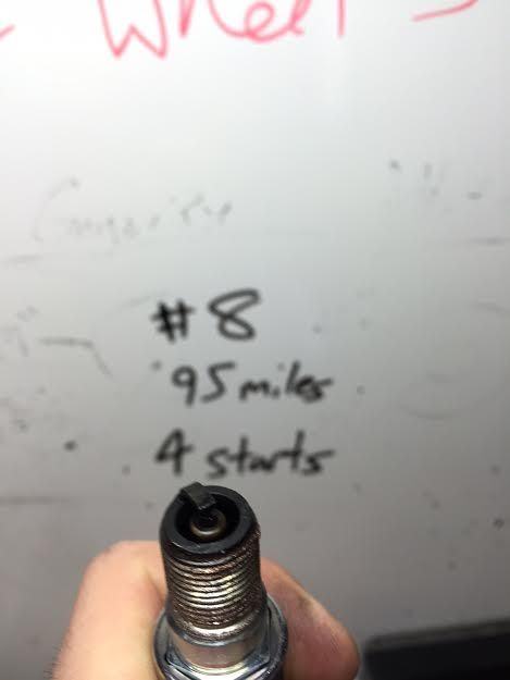

I am losing my mind over this issue so hopefully you can help. I built a new 383 LT1 and it runs fantastic normally, but on cold start-up it is having a persistent issue where it runs really rough and dumps white smoke with a strong fuel smell out the tail pipe. If I rev it a bit and start driving then it runs great. I can shut it down and start it up again a little later and it fires up without issues. However if it sits overnight and I start it, it is rough and smokey again. It always fires up immediately though. Clearly the engine is flooded or not getting appropriate spark. The car didn't seem to have this issue for the first few weeks with the new build but is consistent now.
Related engine info: LT1 383, Optispark, new plugs (NGK BR7), new 8mm wires, Bosch 42# injectors, new MSD coil, OEM ICM, AI200cc heads, cam specs: 235/243, .579/.597, 110LSA.... let me know if you have any more questions on the build.
It is clearly related to either engine/component temperature or time the engine is off since it only happens if I haven't driven the car for a while. Leaking fuel injectors makes the most since based on that but it is odd to me that all the plugs are so fouled which makes it seem that flooding condition impacts all cylinders.
Take a look at what I have trouble shot at so far and see what you think:
For reference, here is what my new spark plugs look liked after 4 starts and 95 miles of driving:

First start with the basics, why are your running a 7 plug for NA? this may be too cold for your start up, the motor needs to be on the rich side at start up like a carb with choke, the plug could be too cold for this then after it warms up its fine. what is your FP at start up, it could be the opposite, could be lean and the PCM is dumping fuel...
Old Nov 19, 2015 | 07:32 AM
1quickTransAm's Avatar
Joined: Apr 2008
Posts: 393
I run nitrous. I have run these plugs for years and never had an issue with the old engine, but the new engine has higher compression and much bigger cam so who knows. I never thought about that being an issue though so thanks!
I'll need to check the FP at start-up. I had figured that it was fine since it fires right up when I turn the key but it would be better to know the actual #.
I also noticed this morning when it was doing the usually running rough and smoking at start that my wideband gauge was showing a normal/slightly lean number of ~15:1 when it was idling rough about 10 seconds after starting.
