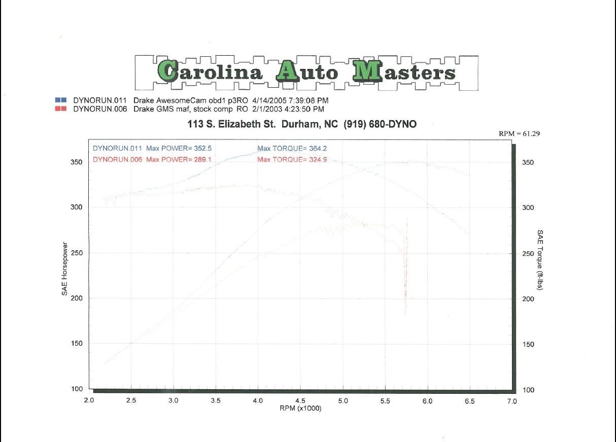

When I was "cam only" I ran a XE 224/236 cam on a 112 lsa with stock, untouched heads and mid-length headers, full catback exhaust. The SAE numbers were 352/364, with a power peak peak at about 6000 or so rpm. Nice fat torque curve too. Here's the dyno graph (sorry it's a bit hard to read, it dates back to 2005). The uncorrected numbers were 358/370.
I could have gotten probably a small handful more out of that setup by switching to long tubes, a valve job on the heads, and a .026 head gasket for a small bump in compression. I'd certainly think that with those minor revisions it'd be right on top of the numbers you want.
How aggressive are those XE lobes? Those are good numbers and even my ham fists could probably find another 10hp or so in the heads. Just need to research more on DIY LT1 head porting as I have ported before. I just need the upper end to stay together so the bottom end can too. It's going to live at 5000-6000 RPM.
