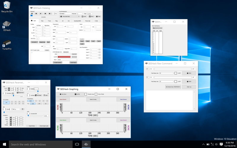

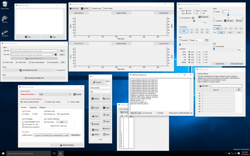

Main Menu (unadjusted DPI)
Auxillary Screens (unadjusted DPI)
Fixed! (adjusted DPI to 72)
Quick update: Screen scaling feature in Windows 10 was set to 150% with a resolution of 2560 x 1600. Changed it to 100% with resolution of 1920 x 1200. Problem solved. Graphs look right and can read all labels.
