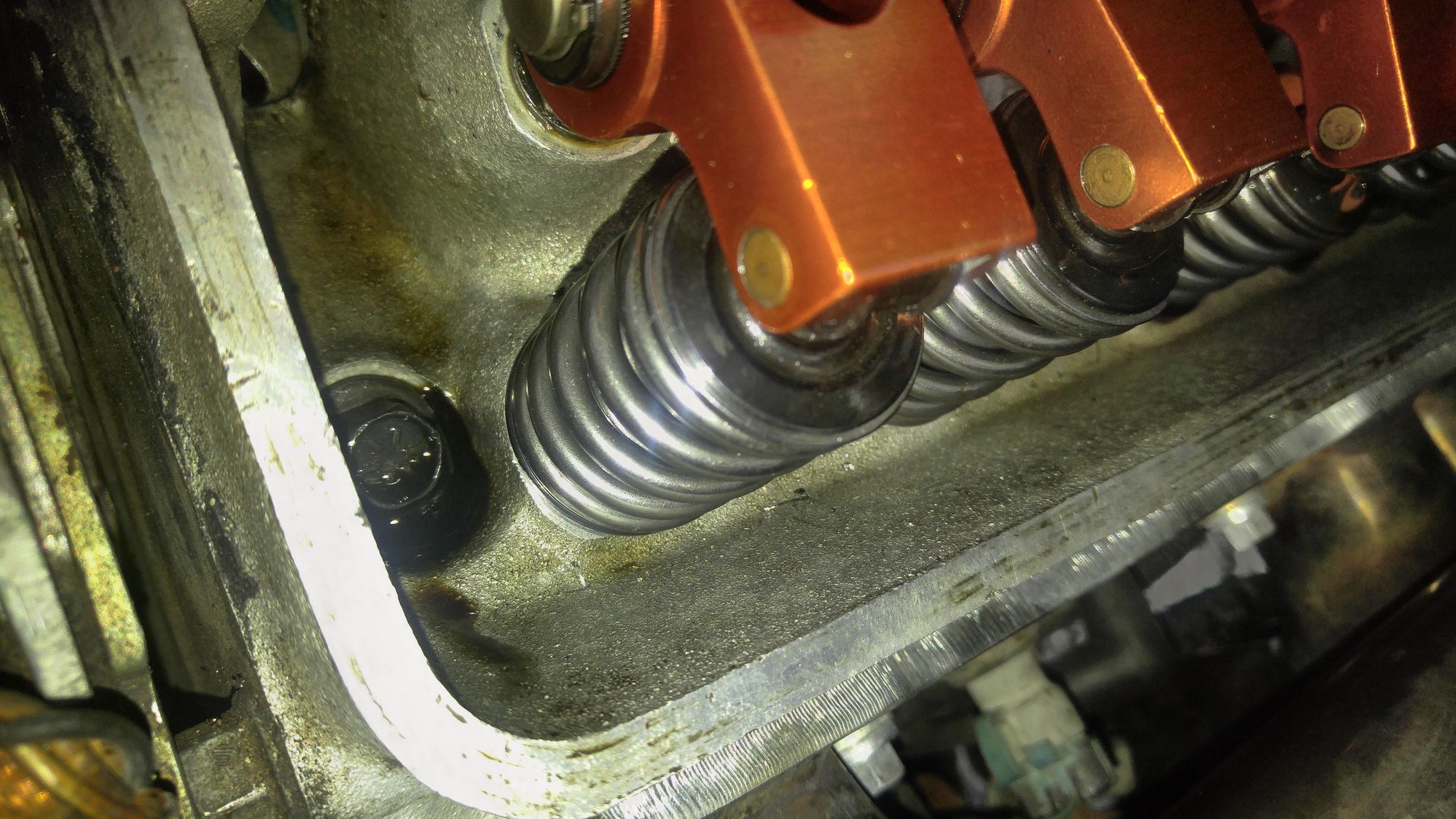

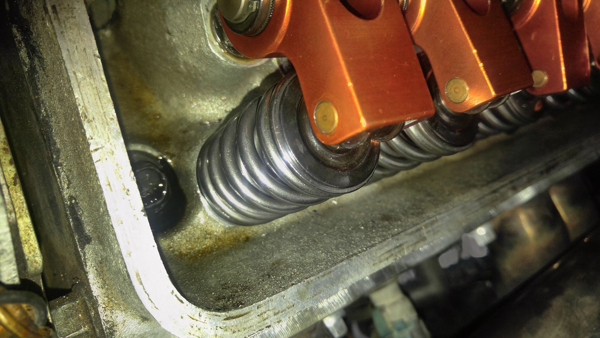

The +.050" Crower Locks (P/N: CRO-86107X1-16) locks fit the Lunati retainers beautifully! But it turns out my Valves are +.050" (or something, they have less stem beyond the lock groove than my stock ones do), the combination of the locks and valves only left me with about .040" clearance for the RR. I'm running SA RR's so this doesn't work. Now I have 2 sets of +.050 locks that don't work for me. Ugh. But, If I had stock type valves (where the groove sits further down the stem), I'd have no issues with the Crower Billet locks.
The Locators (P/N: CCA-4682-16) fit perfectly. Even though they are only 1.300" wide and the Springs are 1.306" wide, the Springs don't over hang the Locators at all. Not sure where they got the 1.306" measurement, but I think the base of the spring (because it's cut through the coil to make it flat) is a tiny bit thinner than the body, so it works great.
My installed height is now 1.755" which gives me a seat pressure of 174, after break in I should be 164-169 ish. And 388 over the nose; 378-383 after break in. those numbers look a lot better. I should have everything done by the end of the day today.

No, the valve stem over all length is the same, but the groove on the valves on my head are .040-.050" higher on the stem than my stock ones. That increased my install height. So, with those valves the Lunati kit still installed at only 1.715". With stock valve it would be been even shorter!
I measured the difference between the stock valves and the ones in my car, it came out to .040". With the Howard's .050 lock I had .010" clearance from the alignment tabs and the locks. With the Crower locks the alignment tabs hit the locks. If I had stock valves I could have gained another .010" in installed height over what I have now, with the crower locks.
Now I'm running everything in the Lunati kit minus the locators, using the comp cams locators that are .060" thick. Current install height is 1.755". I cant get any higher than that without machine work. If my heads ever come off again, I'll have the spring pockets machined down.

Everything is in with new seals and rocker studs. Runs good-ish. Held it at 2K rpm until warm for the break in and was getting the occasional pop in the exhaust; AFR is off now. I only did 1/8 turn past zero lash this time, but I wonder if the additional seat pressure is bleeding down the lifters and causing it to act like a smaller duration/lift cam throwing the tune off a bit? I'll be adjusting the tune throughout the week.
I did measure one more time after cranking the engine over a couple times, gained another .005" install height with everything fully seated; bringing me to 1.760" installed height. So after break in I should be right around 160-165 on the seat and 376-381 over the nose. The engine does rev a bit quicker, idles smoother (I think this is related to the bleed down), and sounds stronger too. To be fair though, I was getting valve float at 6K with the last set of Howards 98215's. Felt like I hit a speed limiter at 6K, that's what prompted this spring change. I also found 2 more broken dampers, but no damage (other than a scraped up seal) though. So got lucky there.
So after 26K miles and 32 Howards 98215's, set up to their max on a fairly aggressive cam profile, I had 14 broken spring dampers and 1 broken spring. Not too bad for $120 springs. This set should go for 30-50K according to Lloyd as I'm set up, and ran me $280 ($703 if you include the both sets of locks that didn't work and the 10 days of Rental car). But, next time I can get just the springs for $150! I'll take it. I may order a spare set to have on hand at about 15K miles just in case though.
For those that are interested here's all the parts that will work together.
Lunati 73925K5 Kit (Locks, Retainers, Locators, Springs, and Seals)
Crower 86107X1-16 (+0.050" Locks, these fit the Lunati retainers perfectly. But, depending on your valves and RR's may not work for the set up)
Comp Cams 4682-16 (.060" thick Locators, these fit the head and springs perfectly)
On a stock head with stock Valves, this should get you an installed height range of 1.850" to 1.715". Of course measure your stuff first before you order anything. If I had NSA RR I could've added another .050" to my install height. I'm still kicking my self for that one.
