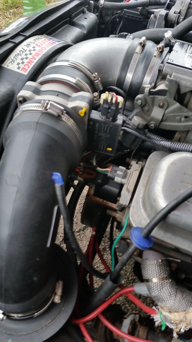

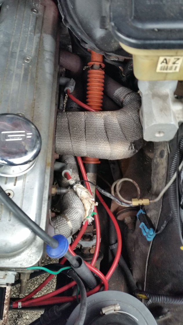

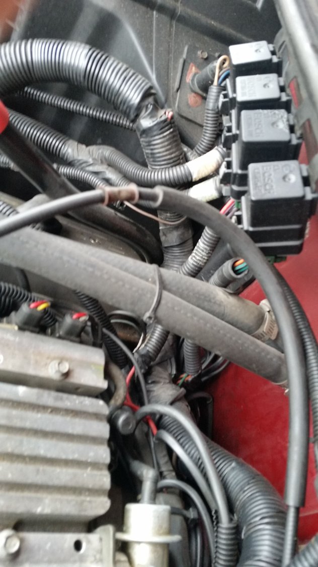

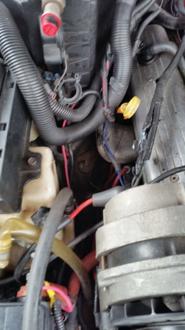

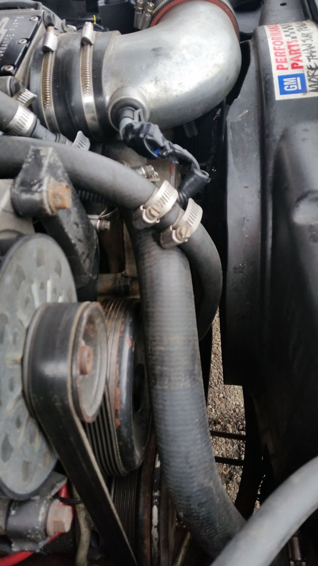

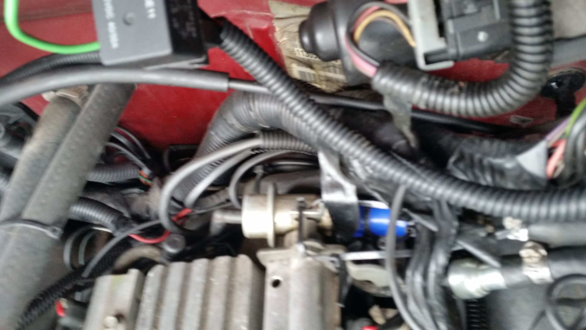

Take some pictures of the back of the intake manifold near the firewall, some of the exhaust manifolds and one of the front of the engine where the pulleys are.
Like with the maf we can tell a lot from pics. If it had egr and air/smog delete we can tell. If no egr block of plates were used that could be why it runs poorly.
I say get pics loaded up since its free and people can at least notice anything major.
I was thinking speed density until I saw the pic of the maf lol.
I'm curious what the fuel pressure regulator looks like. If the vac lines are not hooked up you will get poor gas mileage, and the weird starting issues. Mix that with pirate air from no egr block off plates and your going to have a very odd running car.
I would also trace plug wires and make sure none are melted, the right plug wire being burnt can make a lt1 seem almost normal, it will idle fairly smooth and drive ok if your foot isn't in it, but it's running on 7 cyl. Some cylinders not fireing are more distinguished then others I've notice.
The o2 problem is weird. You cod start by getting a pcm pin diagram and see where the wires go from the computer.
Makes me curious about the knock sensor too.

Heres those pics trilkb

That's actually not that bad. Hell, that's better than most mid 80's WTF stock vacuum web of **** that manufacturers had. All you need is some time, zip ties, electrical tape, and beer. Make that **** all neat. Well, from the top anyway. How bad does it look from underneath?
What you need to do is start eliminating possible causes of the problems. Checking fuel pressure for example. If you check fuel pressure and it's good, the you know you need to verify the wiring of the fuel system, assuming **** was installed right the first time. Checking the Coolant temp sensor (on the water pump), if that's reading the correct resistance for the temperature than you need to look at wiring, if not replace the sensor.
Personally, I'd do a OBD1 PCM swap to get the awesome data logging software available, and re-wire the whole truck if I needed to. But, that's me and you may not be able to do all that.
Can you read a schematic? It would be time consuming, but you could trace every wire from the PCM to what sensor (or light, solenoid, gauge, motor, etc) it should be going to. Then once everything is in the right place, you can zip tie it up and mount it all pretty like.
