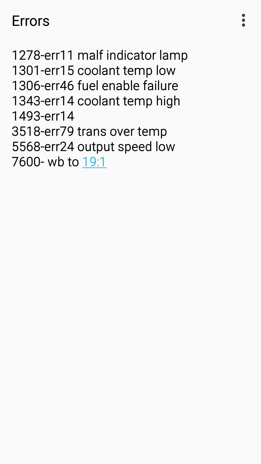

Okay so I have gone on two 150 mile trips....when I get back I full up and I also fill up before I leave, so I know how much gas I'm going through, and I'm constantly getting about 11mpg...what the hell is going on! Car was an auto, swapped it and tuned it....honestly can't tell u what I was getting for fuel milage before because I was running the auto in 3rd only (all gears fried) other than the swap and headers and a Cai and 56mm throttle body...cars stock, oh and lt headers and straight pipes....cat starts hard, as in I believe my fuel pressure regulator is going out. Gotta prime it twice or else it cranks for 5 to 10 seconds....other than that car runs good I believe....just absolutely GUZZLING fuel....I see others getting 20mpg and I'm like **** thats great! But this is hurting my wallet so anyone got any ideas?

Iv included a pic of the error codes and at what time they occured....can't upload data log till later
Old Jun 7, 2016 | 12:33 PM
Bengtson95's Avatar
Joined: May 2015
Posts: 367
From: connecticut
Okay guess it didnt work the first time but here it is...dunno if this helps, will upload full datalog after work
Old Jun 7, 2016 | 01:54 PM
atlantadan's Avatar
Joined: Nov 2011
Posts: 471
Likes: 14
From: Tucker, GA
Out of morbid curiosity, what program was used to log these errors?
If your ECT sensor is malfunctioning (and it appears to be) that can cause the car to dump fuel.

Another thing, before I got the malf indicator lamp I was at wot and it would cut out....like stop getting fuel and studder...figured I'd give it a wot during the data log

Ahh okay....coolant temp sensor in my waterpump?
Old Jun 7, 2016 | 06:49 PM
myltwon's Avatar
Joined: Jul 2004
Posts: 2,965
Likes: 7
From: Palm Harbor, FL
I forget which is which. There is one in the driver side cylinder head and one in the water pump. One sends a signal to the gauges the other to the pcm.
Old Jun 7, 2016 | 06:52 PM
Bengtson95's Avatar
Joined: May 2015
Posts: 367
From: connecticut
Yeah as far as I know one on the block Is gage, waterpump is pcm....come to think of it I broke off the head off the connecter on the wp, so it's just two metal prongs that I put the plug on.....that could really cause all this!! Seems so small to b my problem lol
Old Jun 7, 2016 | 08:37 PM
Bengtson95's Avatar
Joined: May 2015
Posts: 367
From: connecticut
okay im trying to upload these datalogs......its not letting me.....how do i do it? trying to use the paperclip in the toolbar. also realized my afr goes from 14ish to 18ish when i turn the ac on.....seems a bit excessive...also swapped my coolant sensor on the waterpump. didnt notice the coolant codes come up again.....my sensor was definetly broken though, the plug spun on the actuall sensor so even if that wasnt my issue, needed to b replaced reguardless

Well now you guys r gonna think I'm dumb....today I had an epiphany, my speedo is off cause I did t56 swap...tried to tune for 2.73 and 6spd but didn't work but tuned for 4.10 and 6spd and it worked so my speedo is off by 1.5 times. As in speedo says 40, I'm doin 60, 30=45 20=30 so on and so forth, just realized that messes up my milage so on my 160 mile trip, I really went 240miles, which i 18 mpg about....not too bad....alot better than I thought
