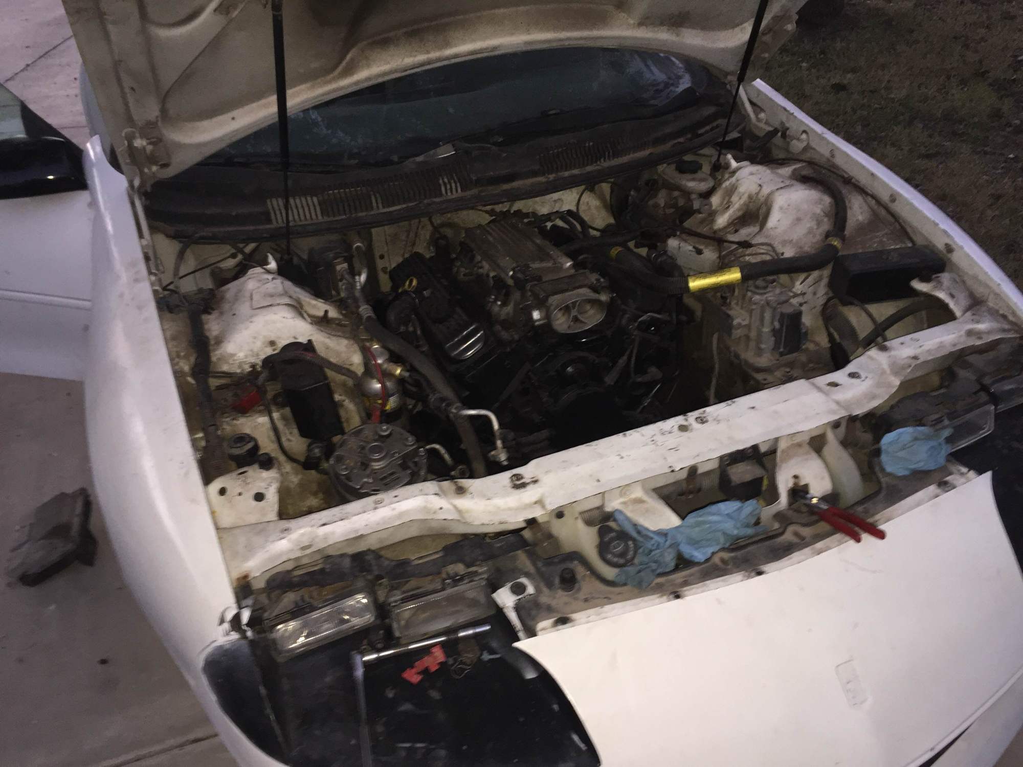

Well I got it home Saturday night. I got her from a kid off cragslist for 1000. The poor guy had spun a rod in his old motor and the shop who said they had an extra laying around installed what I think is an L99 that also ended up having a spun bearing, thing sounds horrid. Those guys also chopped up the harness pretty bad,left the interior and engine bay in various states of disassembly. I pulled the heads on the original motor yesterday, the bores look ok and the pistons indicate its already .30 over. I'm gonna pull the pan tonight to get a look the the rods and crank as its going to machine shop tomorrow morning. I want to rebuild the bottom with some quality parts and install a new valve-train with a larger cam. I'm wanna go as big as I can with stock flowing heads. Its just gonna be a weekend car not a race car but I'm planning on running a 100-120 shot just for kicks.
Not sure on much but if the block is serviceable I'll be studding the mains. If the rods are serviceable I'm reading here that arp bolts are a must? Anywho any advice on what do to while the motor is out would be much appreciated.

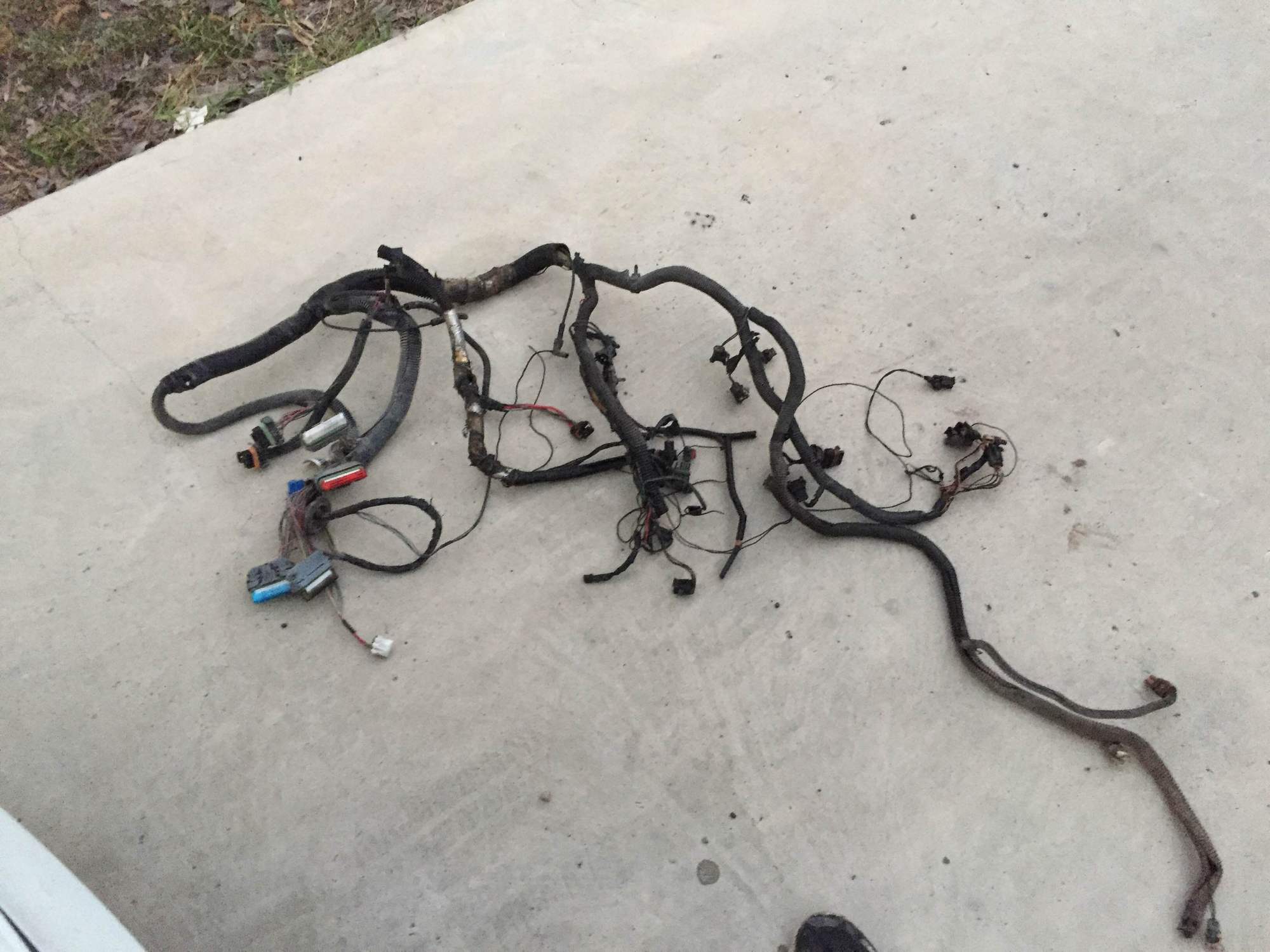

- If the harness is chopped up find a good 94/95 harness and swap it in. Nothing like chasing wiring when a new harness will fix 99% of it.

Made some progress, Pulled what was left of the accessories and the trashed harness.Driveshaft is out so not much needed to drop the motor when I'm ready. The terminal on the alternator is broken its just spins in there bolt and all so I'm add a new one to the list.

I spent most of last night cleaning the interior,ripping out a crappy alarm/ stereo wiring and beating my head against the floor wondering why the the locks and power mirrors wouldn't work knowing I did the rewiring correctly. I had power to the switch but nada. Turns out the number 7 fuse was blown and feeds whatever else they need to work the way the factory intended. Got the call this morning and my crank is shot, there's another machine shop here in town that says they have some. They may even have a standard sized one he says. $195 with bearings. Is that not a bit high? Bores and mains look good so I'm not to worried about that its the rods I'm more concerned with. It's already .30 over so if more than one rod is bad I may as well suck it up and stoker or get a short block of eBay. Seem to have good reviews.What do you guys think?
