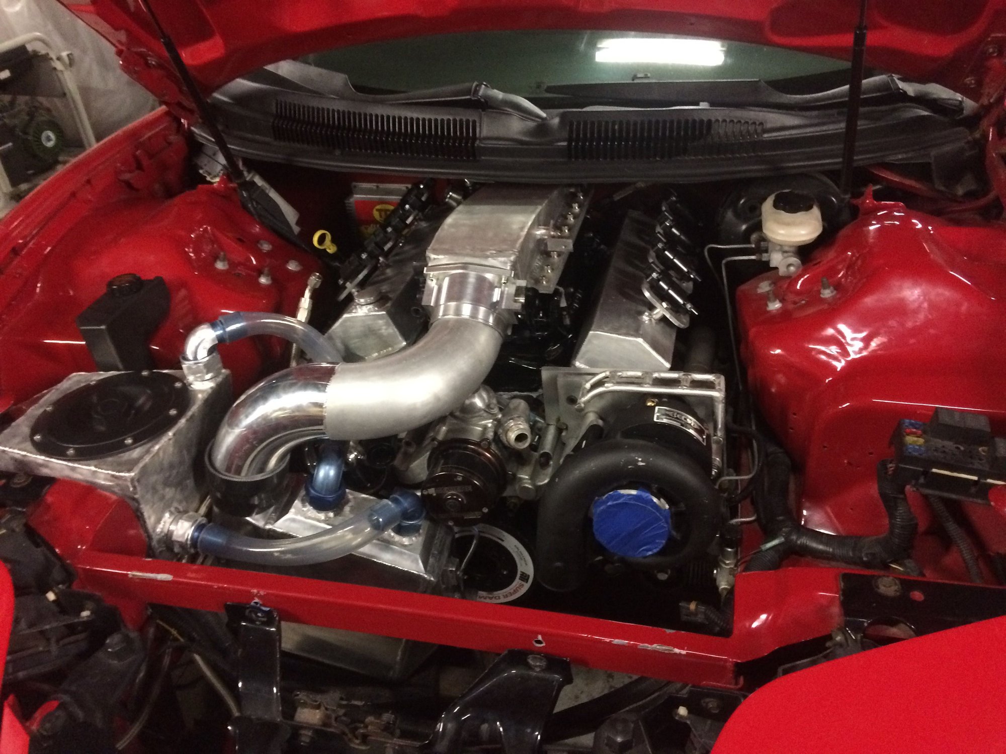

Drove my setup in te shop about 4 months ago.. built a custom sheet metal intake, A2w intercooler on a Paxton reverse drive blower, didn't touch anything electrical (none of that changed
installed new battery and when connecting the new battery it kicks my fan on and the dash lights and I have NO way of turning them off... when I turn the key ON I don't hear the pump but it attempted to crank for the second I tried!!
what the hell is going on!???
Electical stuff is not my thing...
any help or ideas??

2 grounds at passenger head connected and tight!! And the temp sensor on base of water pump connected (I remember these)
so it sounds like a ground issue to everyone??
no recent pic... but I took this about a month ago
