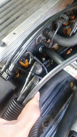

I'm in the process of replacing my fuel injectors/fuel pressure regulator on my 1993 Trans Am LT1.
I used the fuel line disconnect tool to disconnect the 2 metal fuel lines from the drivers side near the schrader valve, disconnected all electrical connections, removed the vacuum line from the FPR, and removed the 4 bolts on top of the rails.
When I pull the rail up from each side, there seems to be something else in the back attached to the metal lines preventing it from being pulled out.
Most of the videos I've watched were 94+ and don't seem to have the same setup in back preventing it from coming out.
I did notice there are 2 (torx?) bolts near the back - but they seem almost impossible to get to without pulling the assembly out.
Any help would be very much appreciated - thank you so much

Not so sure about a '93, but my '96 Z/28 had a line to the fuel pressure regulator hooked on, in the back of the manifold.

I was able to get the rails off by removing the bracket holding the lines to the manifold. Unlike 94+ my hard lines came out with the fuel rails.

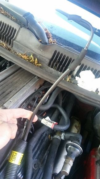

When I was reassembling everything I noticed something interesting. There's a vacuum line attached to the 2 hard fuel lines that I don't believe was ever attached to anything. After feeling around back there, it looks as if there's 3 vacuum lines that attach to the (EGR Solenoid?) and the far right one is missing.
Is that where this line is supposed to attach? If so, my vacuum line won't reach back there - it's way too short lol

I am not sure how the '93 is configured, but I believe the line coming out of the fuel line cluster is for your EVAP solenoid.

Perfect - thank you sir.
