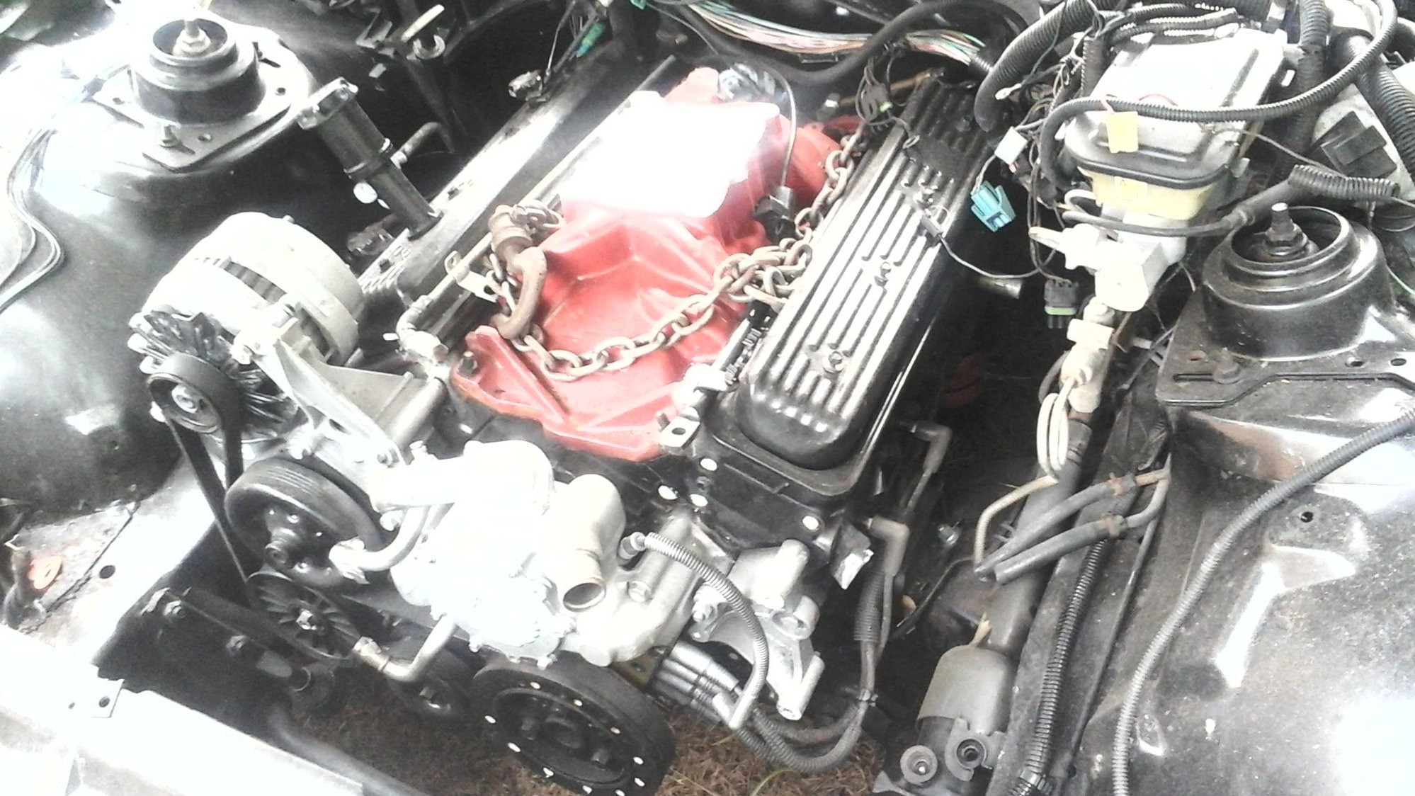

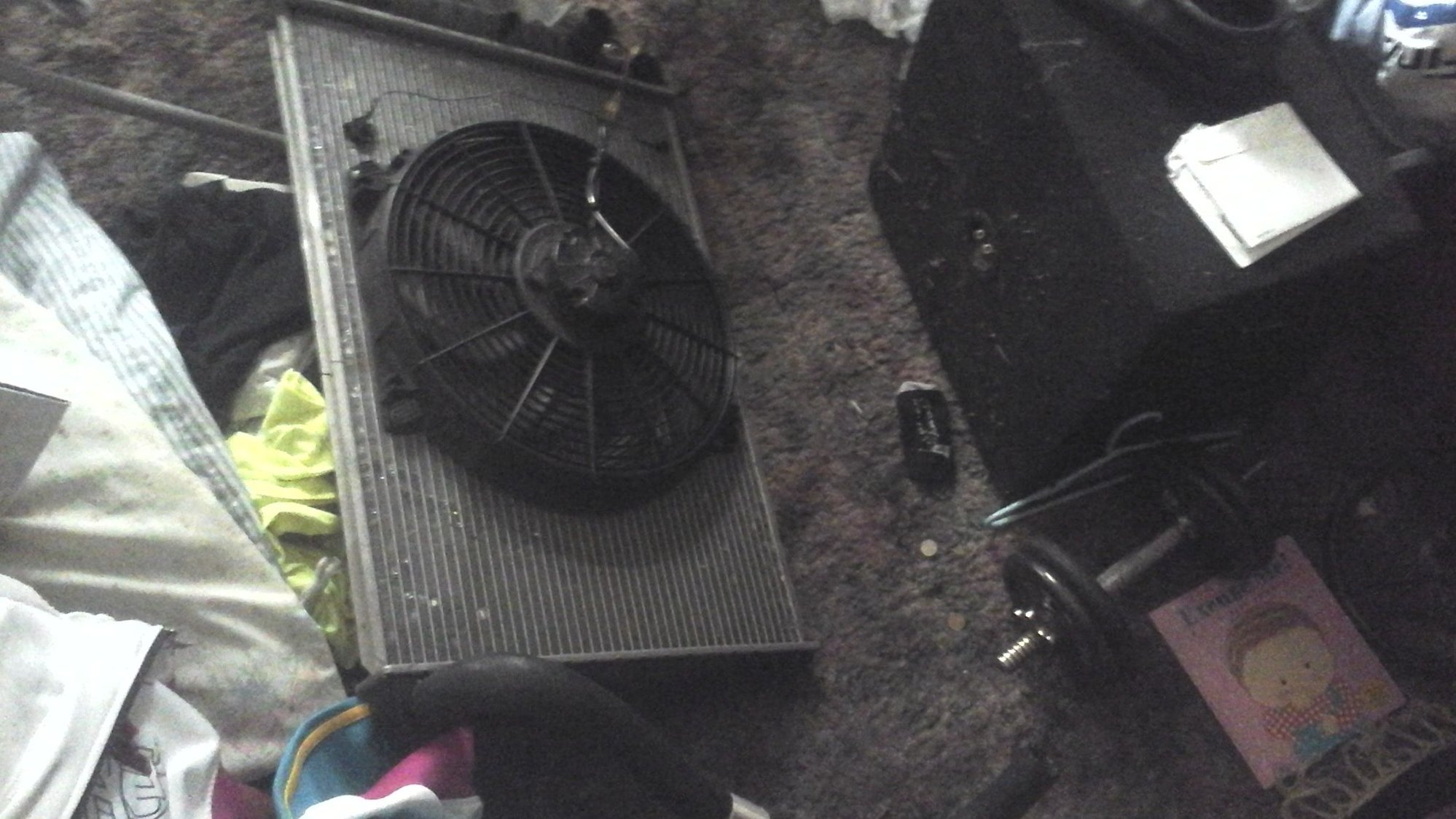

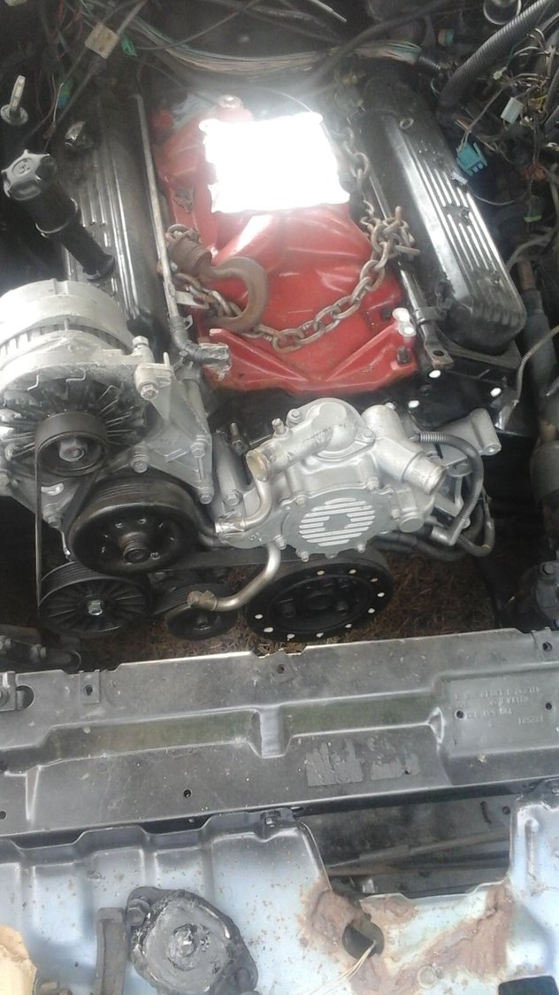

Radiator im going with do i need to go with two cooling fans?

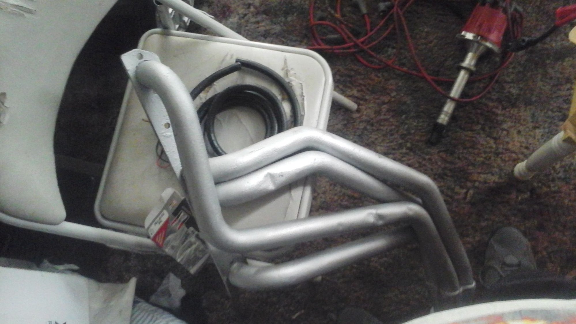

Long tube headers

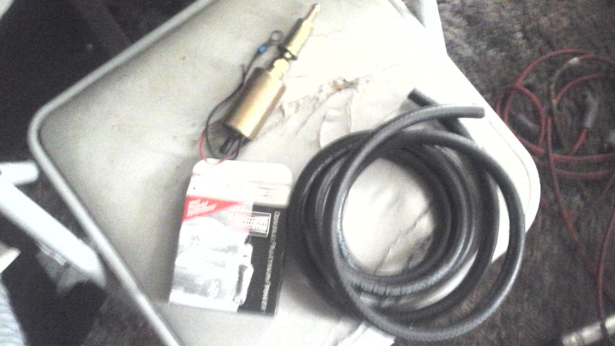

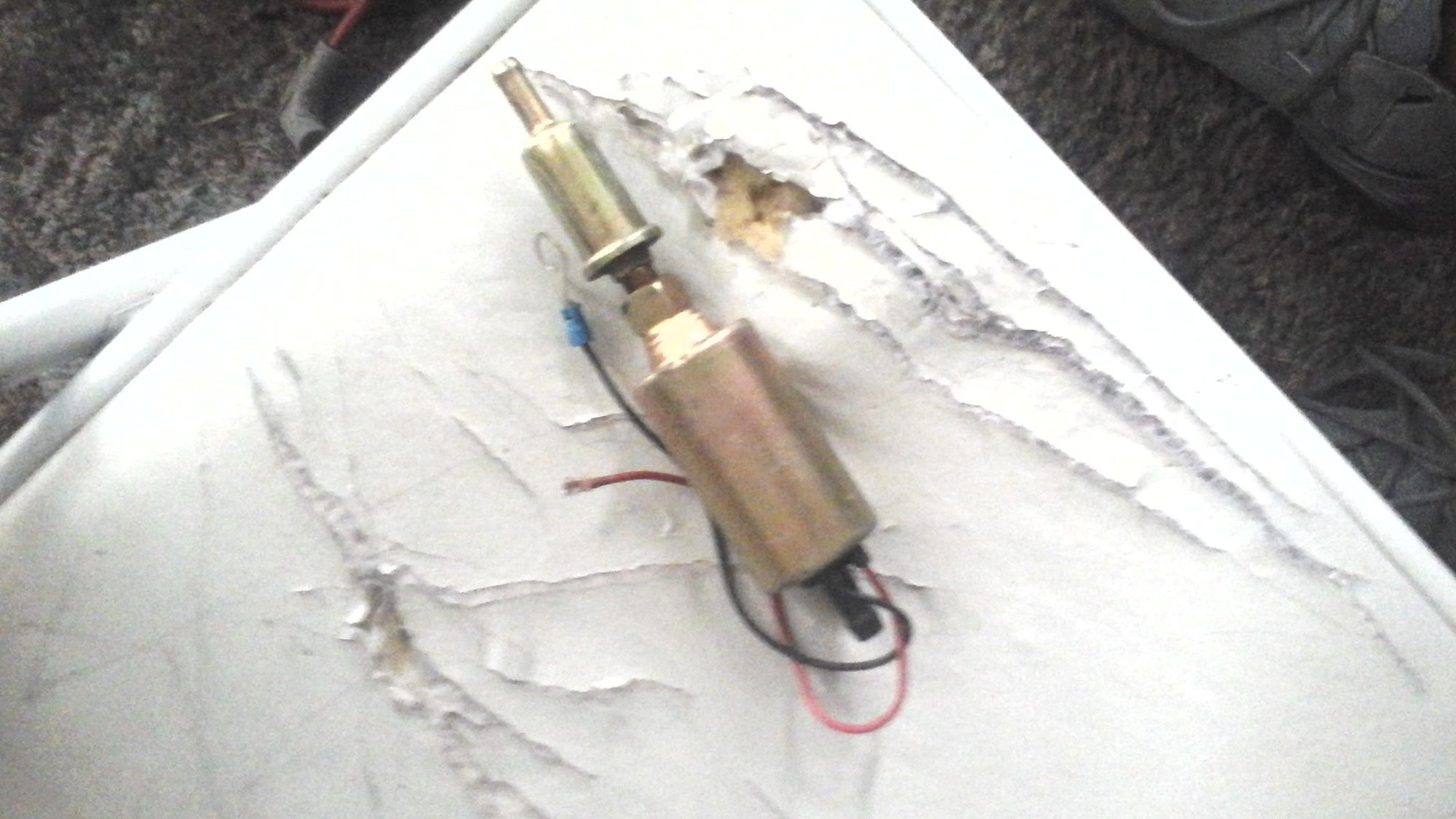

Fuel pump and 3/8 line
Fuel pimp

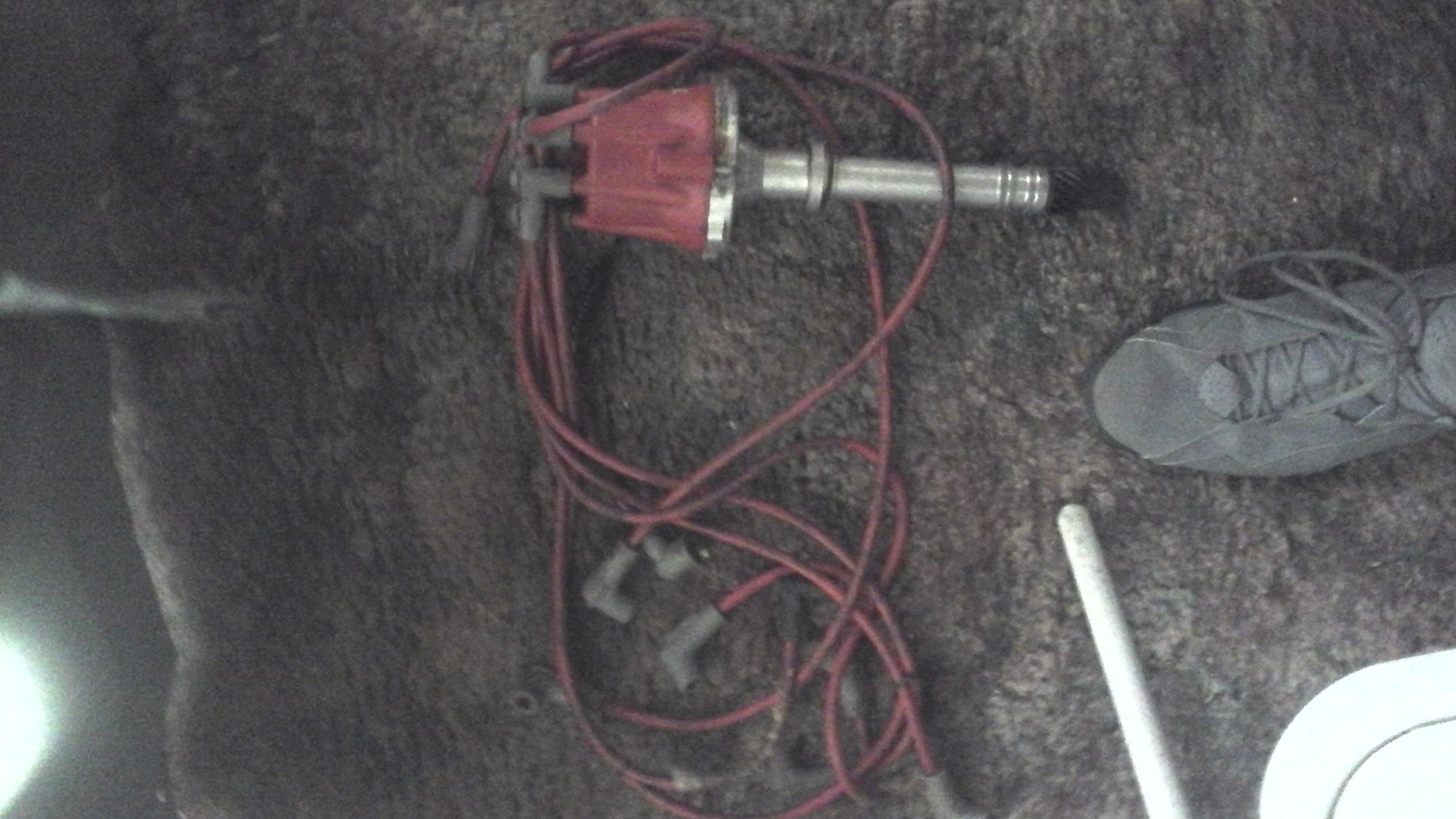

Msd distributor and wires
650 manual double pumper

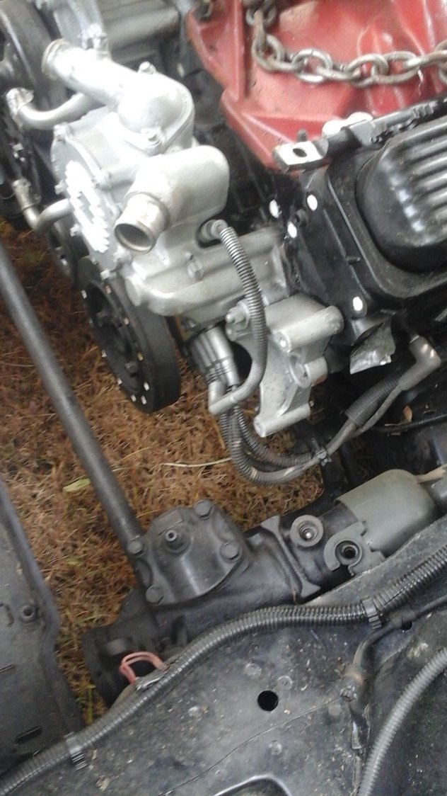

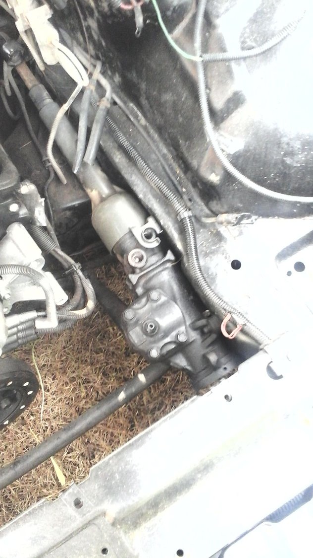

What's the name and length of the hose i need here not using power steering pump

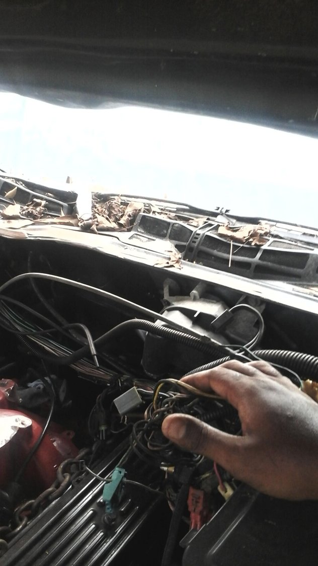

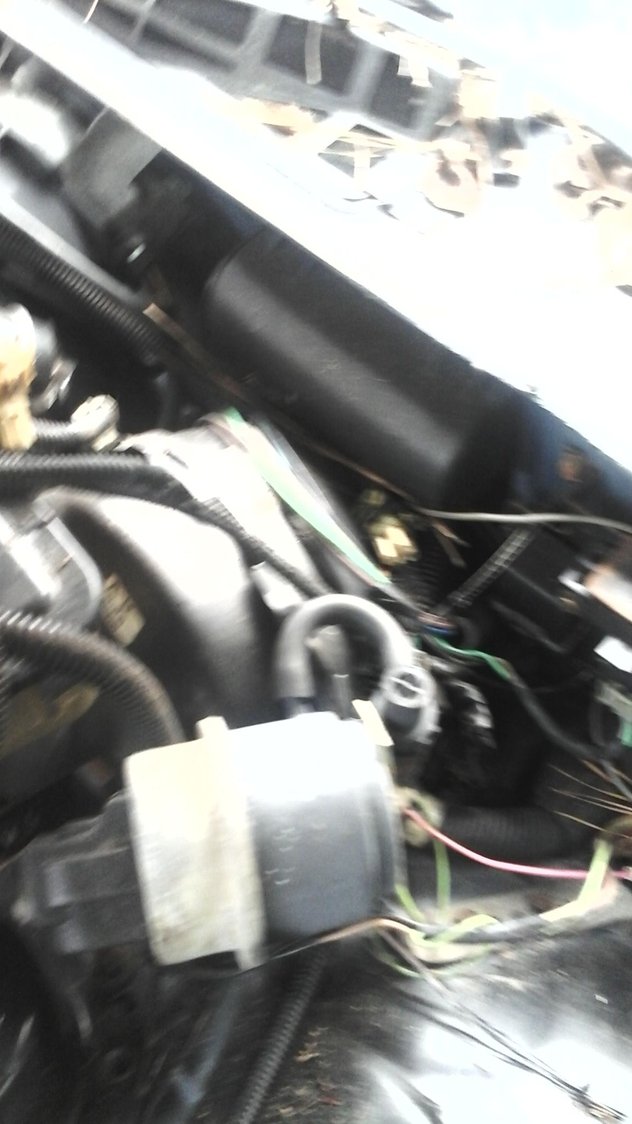

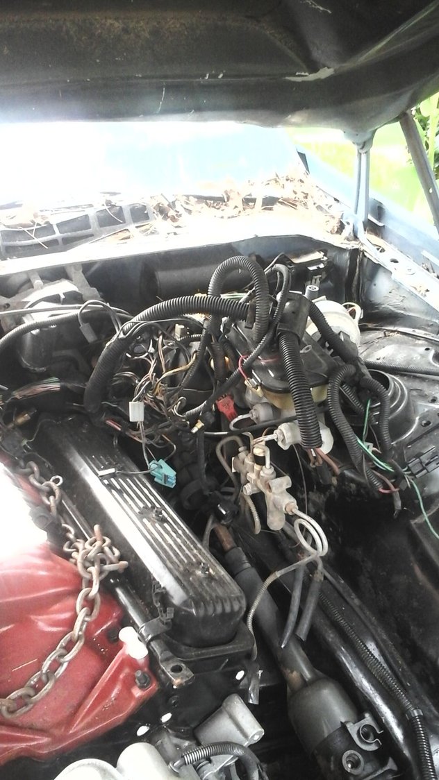

Wiring harness from the car , what do i connect to it?
I need he completing my project , where do I go from here?

I don't know what you are asking about the 3 lines above the steering sector. You can use the appropriate rated rubber hose. So the only stuff that cost a fortune is fuel injection hose.
I've ran a carbbed and a injected setup on an lt1 before, all I used from the car was a hot to the distributor.

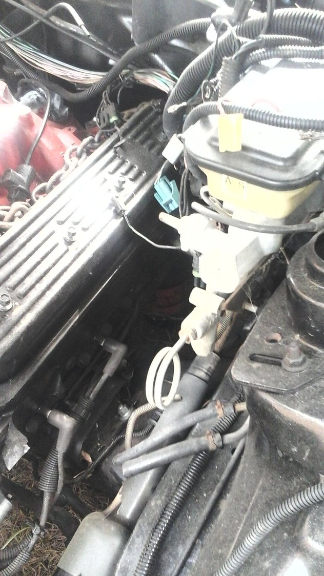

You might have issues with the steam line hookup since it will have to be tied into the return lines.
The carb intakes like a super vic will not match up on the gasket, so you will have to plug coolant crossovers and mill the bolt holes.
You will need to plug the timing cover or just leave the opti on there.

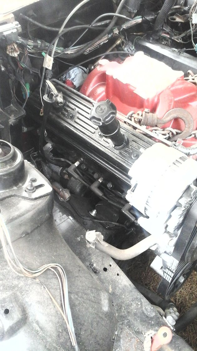

Ok the motor and transmission are jus siting in the car. The wires are the wiring from the car. it was v6 fuel injection the question is do I need a 12 circuit wiring to wire it up to the car and the engine to get the engine to run . Im goin with the msd distributor so I'm jus gonna leave the optI spark on .this setup is in a 84 firebird
