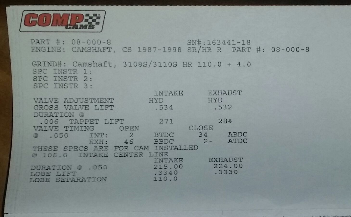

Old Feb 5, 2019 | 10:49 PM
  #97
Fast355's Avatar
Joined: Oct 2006
Posts: 993
Likes: 173
From: Euless, TX
Originally Posted by dirtybob
LSA without any other spec is pointless.
Relatively short duration with a tighter LSA and advanced ICL builds cylinder pressure which builds torque. Lift and Cylinder head flow build power. That cam is not far off from what I am running with Assault Racing 205cc heads. I just had a set ported by Lloyd​​​​​​. I am using a 1.7 rocker arm in my setup. I have a ported L31 Marine intake. Also have Doug Thorley Tri-Y headers. I am expecting somewhere in the 460-470 hp range out of a 9.6:1 350. Also should see around 440-450 ft/lbs of torque across a broad RPM range. The Marine intake runners are about 1.5X the length of a LT1 runner. My only requirement was this cam have good manners from 1,500 rpm and have a decent idle at no more than 850 rpm. It idles in drive with the a/c on at 750 rpm with 15 in/hg vacuum. From 2,500 rpm this cam and out of the box Assault heads made more grunt than the 2.02/1.60 valved 906 Vortecs and the GM 395' marine cam with 1.7 rockers did. The converter was stalling about 2,500 rpm with the Vortec/Marine cam setup and about 2,700 with the larger 215/224 cam and 205cc head ports. When I am in the throttle it is never under 2,700 rpm. At WOT shifting at 6,200 1-2 and 6,100 rpm for 2-3 the shift recover is right at 4,000-4,200 rpm.
Cam Specs
271/284 @ .006
215/224 @ .050
.578/.578 lift
110 LSA, 106 CL
Head Flow
Assault Racing Heads
Ported by Lloyd with 2.02/1.60 valves
LIFT------INTAKE-----EXHAUST
.200----------138-------107
.300----------192-------138
.400----------241-------164
.500----------274-------183
.600----------291-------193
.700----------295-------199
This engine pulled like a freight train from 1,500-6,200 rpm with out of the box Assaults only flowing
.200----------135-------103
.300----------183-------131
.400----------225-------150
.500----------244-------164
.600----------241-------175
.700----------241-------177
